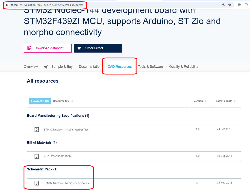

@ap44 wrote:Could you maybe tell me where I can find the pin-configuration for my Board STM32- nucleo-f439ZI. I went through the whole user-manual but could not find it
here:
also here:
@ap44 wrote:there is no CAD-documentation for this board
It's here:
https://www.st.com/en/evaluation-tools/nucleo-f439zi.html#cad-resources

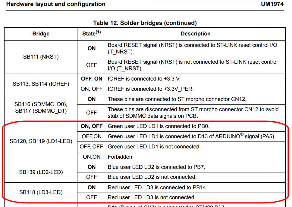

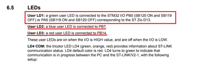

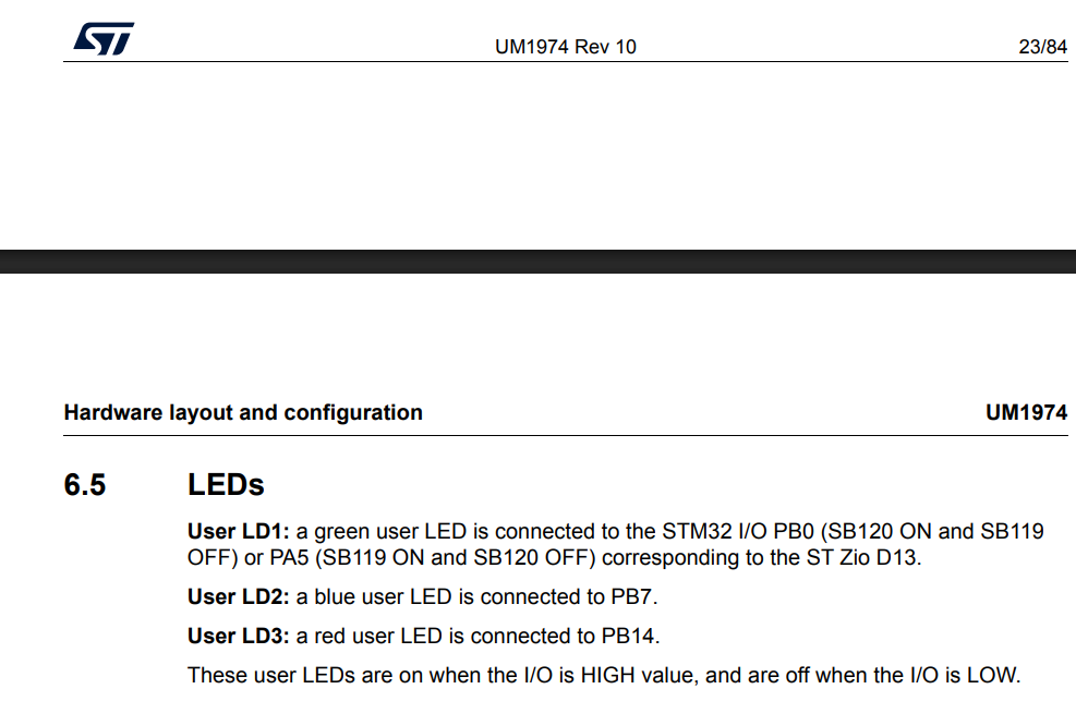

It is now working with this code, so my red LED is blinking, before I tried to let the green blink. Now I switched to the red using Pin PB14, so maybe the Pin I tried to use for the green one was wrong. I tried to use Pin PA5. Could you maybe tell me where I can find the pin-configuration for my Board STM32- nucleo-f439ZI. I went through the whole user-manual but could not find it and there is no CAD-documentation for this board or at least I could not find it.

2025-07-14 2:26 AM
From the user manual of the board:
