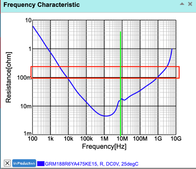

According to AN4661 "Getting started with STM32F7 Series MCU hardware development ":"When the voltage regulator is enabled, VCAP1 and VCAP2 pins must be connected to 2*2.2 μF low ESR < 2 Ω ceramic capacitor. In the STM32F7x2Rx devices, only the VCAP1...
