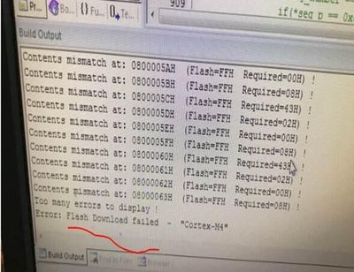

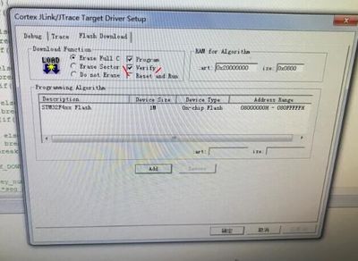

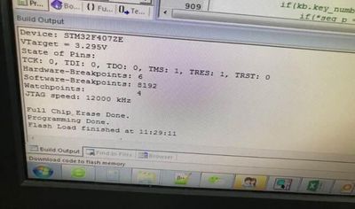

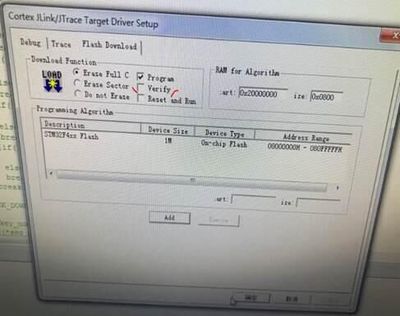

Problem: Normal operation, sudden crash. Re-power failure remainsAppearance:The normal operation of MCU STM32F407ZET6 will output a 20MHz reference clock to CPLD, but the oscilloscope detection and CPLD condition detection confirm that MCU has no out...
