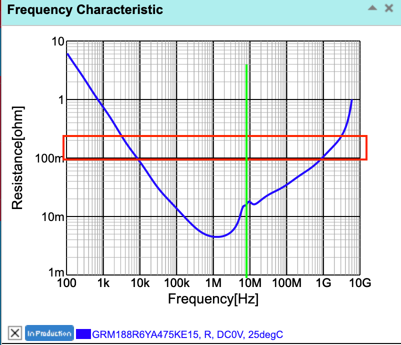

To try and figure out a compatible capacitor, I looked up the BOM from some nucleo boards, and they list the 2.2 uF capacitor - but none of the BOM's list the variation using a 4.7 uF capacitor.
So looking through datasheets of capacitors and trying to understand it, I found several (quite similar) ones, for example this one.
So how do I figure out if it meets the requirement? Obviously it's not in the 0.1-0.2R (=red box) range over the entire frequency... Should I only look at the frequency of my HSE-oscillator (8Mhz = the green vertical line)? And should I then conclude this one is incompatible, because the blue graph isn't in the 0.1-0.2R range for exactly 8Mhz?
Anyone happens to know a capacitor which is compatible with the vcap1 of the F722 in 0603 package?
