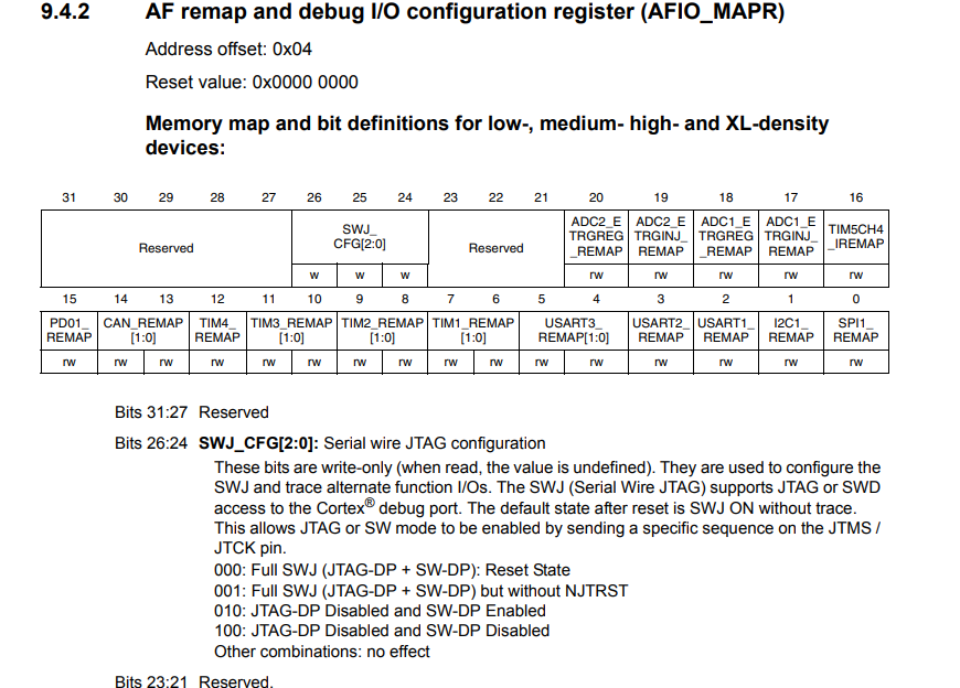

We have also tried to write directly to AFIO->MAPR register to disable JTAG and SWD as explained in Reference Manual Table 37:Debug Port mapping. We wrote 100 to register's 26 25 24 bits to disable JTAG and SWD as you can see from below picture.
So we think that we tried everthing and it is not working well. Could it be errata for this MCU? Is there anything that we can do to workaround?

An attacker will always be able to connect to the chip over SWD if they know how to connect the NRST pin to GND. So disabling SWD/JTAG pins within your program is a very shallow level of protection.
Doesn't look like the F1 family has RDP level 2.
Enabling RDP will prevent them from reading what's on the chip, but they could still erase and reprogram it.
