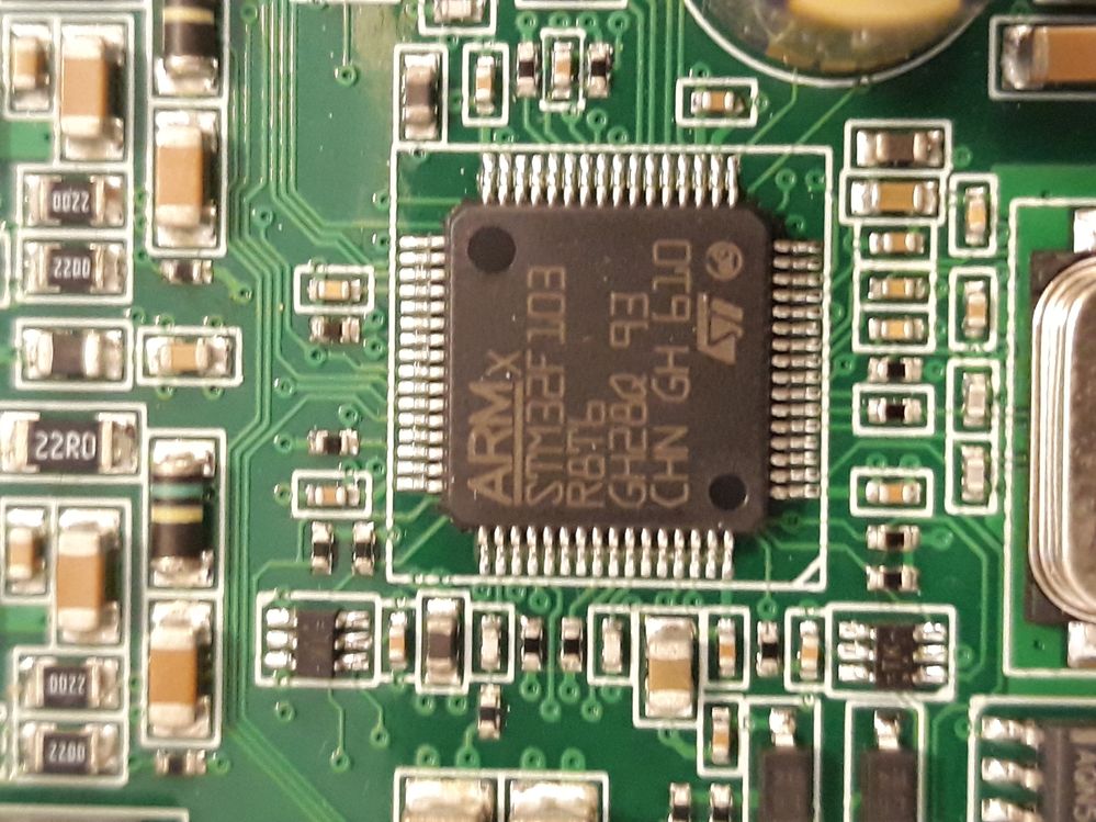

When using the ST-LINK Utility, after connecting to the target , I see :
Device ID:0x410
Device flash Size:64KBytes
Device family:STM32F10xx Medium-density
Flashing a software package of 128KBytes seems to work! Verify after programming shows no error. Even after reading back the package I notice the memory size = 0x1FFFC (about 128K) and content seems intact. The aplication is running (including ROM memory check)!
Does the device have more than 64KBytes memory ??

It's the same physical chip as the one with the bigger FLASH; however, that FLASH is not tested at factory and is not guaranteed to work.
That you casually find it working means nothing, it may stop working at different temperatures/supply voltages etc.

It can happen, but you shouldn't rely on it.
ST probably only make parts in a few FLASH sizes. But it is possible for a speck of dirt to land on a chip during manufacture making some of the FLASH to be bad. Rather than scrap that chip, they probably re-map the FLASH so they are sure there is good FLASH where the data sheet says there is. And sell that part as a small-FLASH part.
It might be that the "bad" FLASH is largely good (i.e. it programs properly first time) but on test they find it doesn't have the safety-margin that ST are looking for, so they don't feel they can guarantee the number of programming cycles and data-retention shown in the data sheet. Or it might be that a particular FLASH cell or bit is stuck either high or low.
If the yield on the parts is good and there is great demand for the small-FLASH parts, ST might decide to make a new mask-set with less FLASH resulting in smaller chip size hence many more chips per wafer. This is cheaper to make per chip, so ST can make more profit and/or sell at a lower price.
