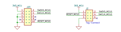

I have been using PE micro Multilink FX for several years, but its Linux support is terrible. Is there a ST (or another) alternative with this functionality compatible with stm32CubeIDE? I just need to supply power (up to 100 mA at 3.3V) to my board for debugging. I don't need high tracing performance or anything like that.
Power is not supplied in the standard 10-pin ARM debug header. All ST programmers adhere to the standard and do not supply power on a 10-pin connector.

It doesn't look like the 10-pin header on the PE micro Multilink FX is any different. What pinout are you using that you want to duplicate functionality?

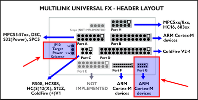

That's right. PEmicro Multilink FX is a special case. I use this:
I connect the port G with my target MCU (standard ribbon 10-pin cable or Tag-connect) and voilà!
The target is 3.3V powered successfully by the debug probe.
Also PEmicro is very clear about the 'to power target MCU' capability
But ST not...
After reviewing several user manuals (STLINK/V2/V3/V3MINIE, etc.), I still don't understand whether this functionality is possible or not. I'm also not sure whether this option can be enabled from the stm32cubeIDE. Can anyone clarify this?

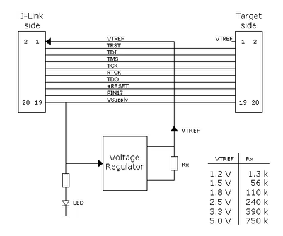

Segger J-Link probes are very good and can supply 5 volts.
It appears they have an adapter for other voltages: https://www.segger.com/products/debug-probes/j-link/accessories/adapters/supply-adapter/.
https://kb.segger.com/20-pin_J-Link_Connector
"Pin 19 (5V-Target supply) of the connector can be used to supply power to the target hardware. Supply voltage is 5V, max. current is 300mA. The output current is monitored and protected against overload and short-circuit. For more information about how to enable/disable the power supply, please refer to Target power supply "

Great. Thanks TDK & Chris21 for the clarification! Just one thing:
Interesting. I didn't know about this adapter.
I believe this offers the possibility of removing VCC from the target board connector (maybe to simplify the PCB layout?). This way, it ‘tricks’ the debug probe for monitoring its own voltage (pin19) instead of monitoring the target MCU voltage. With all this, it does not end up providing power to the target MCU.
