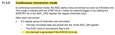

The reference manual mentions the following:
In continuous conversion mode, the ADC starts a new conversion as soon as it finishes one.
This mode is started with the CONT bit at 1 either by external trigger or by setting the
SWSTART bit in the ADC_CR2 register (for regular channels only).
After each conversion:
If a regular group of channels was converted:
–The last converted data are stored into the 16-bit ADC_DR register
–The EOC (end of conversion) flag is set
–An interrupt is generated if the EOCIE bit is set
Which leads me to believe that after setting CONT then SWSTART needs to be set just once for the continuous mode to kick-in, but I may have misinterpreted that. So, a bit confused as to why the above setup doesn't work as expected.

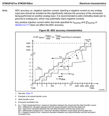

Question 2:
How is the converted value in DR meant to be interpreted? Is it meant to be read something along the lines of DR * Step_Size? (with step size being Vin / 2^16). I couldn't find that anywhere across the RM, UM and DS documents.

Q2) For a 12-bit value, the voltage is COUNTS * VREF / 4096.

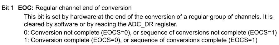

Conversion rate being faster than the loop (i.e. EOC is flipped so quickly that the inner loop can't catch it) is an interesting thought but based on the RM that flag is only cleared by reading DR or by clearing it explicitly:
so even if that happened (and it doesn't look like it is flipped by hardware) then EOC would remain set until the program read it in line 6.
