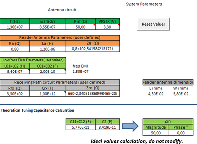

I'm trying to measure X-Nucleo-nfc03a1 with VNA:
i got completely different values for C11 C22 and C2 as is on nucleo board. I understood something wrong?
and when I remove Resistors 330ohm, inductor and 4 100pF capacitors
I got like:

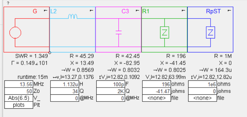

if you use a tool like SimNEC and start the matching form the impedance mesured on the input of the two 47pF capacitances Z=[[Za // (ST95HF ~ 330Ohm ~330Omh)]//82pF] ~ 47pF ~47pF] = 239 ~156pF = 262 // 14pF, you'll see that the result is Zin= 45.3 ~13j which is very close to the measured value Zin = 47 + 15j.

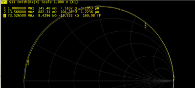

on tx1 and tx2
the question still what I measured wrong in first step that I didn't got the same capacitors as calculated in excelsheet? Any help are welcome

Hello Andy,
as far as I can see, you have changed R1 compared to the AN5248 from 50Ohm to 27Ohm.
Can you confirm that for the antenna measurement in your first post, you have disconnected the antenna?
BR Travis

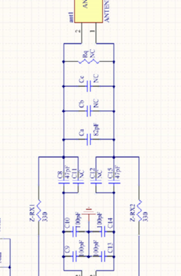

2026-02-05 3:05 AM
Hi Travis,
thank you for your reply
-on the board IC is CR95HFV5 if I'm not wrong is 27Ohm?

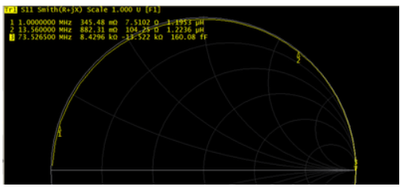

fig1: only antenna I removed component (with 4mm wires on SMA-F connector)

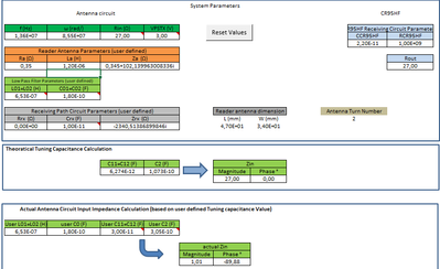

fig2 is not relevant I think because I measured at capacitor Ca with placed C8 and C15 other removed

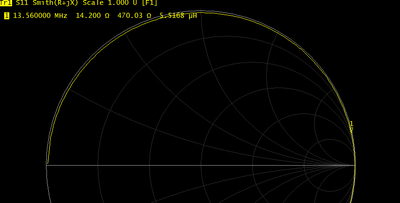

fig 3 is measured on pads of inductor on IC side

In your example you have changed the default EMI filter from 560nH / 200pF to 653nH / 180pF.
I don't know which Rin has been chosen for the X-Nucleo-NFC03A1. When selecting an Rin of 50Ohm the excel sheet gives quite similar values to your picture. (I assume it is from the NFC03A1).
C11/12 = 57pF vs. 47pF
C2 = 84pF vs. 82pF
Maybe some finetuning was done on the NFC03A1 to compensate parasitic capacitance.
Also the used antenna parameter (Ra, La) are unknown. I have not found any document naming them.
Maybe they have changed over time and the values you have measured are not the same as in 2014.

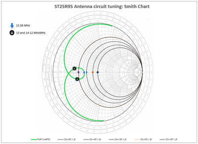

If I understood correctly, Rin defines your matching point (e.g. 27Ohm to 50Ohm). Changing Rin also changes C11, C2. So If you want to tune your device to 27ohm, it should look like this:
I hope, this answers your questions.
br Travis

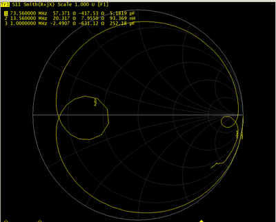

2026-02-10 11:57 PM
thanks for reply.
I know is NRND but I need reference.
I double checked and impedance is 27R not 50R. If I input all component on EVB board I didn't get the same
is there any reference Ra, La and smith diagram for X.Nucleo.NFC03a1?
