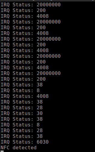

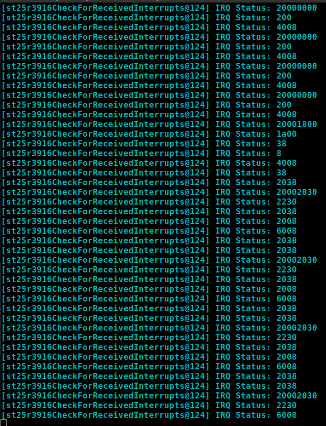

I printed the IRQ status values on both boards, and they are the same while RFAL is running in the idle state. However, when I tap the phone, the values become different.
I will attach screenshots of the logs (values shown in hexadecimal):
Bbb

Hi JPortilha,
hard to say what actually is happening. It looks like an NFC-A card being received and then some error happening during AntiCollision. The error is not signaled from the NFC chip. I recommend to attach a logic analyzer and trace SPI lines + IRQ. This will allow much more educated suggestions on the root cause.
BR, Ulysses
