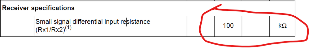

Until this moment this was supposed to be 1 gOhm. And finally you open the CR95HF Datasheet to check the value and there you see this:
Can anyone tell me what's the correct value finally?

the value to be used is 100 kOhm as specified in the Datasheet. The value in the Excel sheet is a typo but as soon as the resistance value is very high, the impact of having 80kOhm, 100kOhm or 1GOhm on the various formulas is insignificant.

Thanks! I've checked the infuelce and it turned out to be negligiblе just as you advised. When you are newbie and something goes wrong you tend to recheck every number you are in doubts about.
