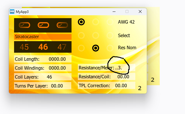

Hi all. I'm having trouble with the following function. My TouchGFX gui
has two radio button groups, each with three radio buttons.
The first selects between three different wire gauges, awg42, awg43 and awg44.
The second set selects between the resistance values of each of the wire gauges.
For each wire gauge, I have three resistance values, min, nom and max to
account for variance in the actual wire resistance in a real-world situation.
Obviously, resistance is based on a variety of external factors.
I have a single TextArea on the screen to which I want to print the decimal
value of the selected resistance.
So for example, I want to select a wire gauge of awg42 with a nominal resistance value
or, select a wire gauge of awg43 with a minimal resistance value and have the screen
update with the result.
So far, this is not happening. The TextArea is updated with the format specifier, not
the resistance value. I have tried snprintf alternatives but without success.
I'm using a typedef struct to hold all the resistance values for reasons of clarity.

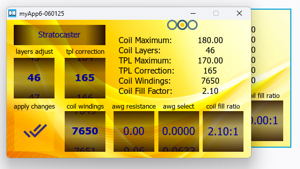

2025-01-13 6:13 AM
Thank you for all of your suggestions everybody. Your input encouraged me to think in greater depth about what I was trying to achieve using radio button groups in preference to another widget type. At some point earlier in the new year, frustration got the better of me and I ripped out all the button code, replacing it with a combination of scroll wheel and scroll list widgets (which, in my humble opinion appear to be much more suitable for my application). I'm not where I want to be yet however, I am over the problem which prompted my post although I still do not know what was causing it.
I'm much happier with the result :)

I can declare an arbitrary floating point value to the 'wire_res' variable and it will print the result to 'wire_res_value' on the screen providing, that is, I bypass the nested if/else if statement by commenting out the entire block of code.
This leads me to believe that I have an issue with the RadioButtonGroup implementation in that the 'getSelectedRadioButton()' calls are not finding the associated radioButtons (I may be wrong, I usually am)?
I'm going to spend some time with printf output to console today and see if it bears any fruit. Thanks again for your time.

}@GaetanGodart Hi.
Also, it seems to print "..3." but what is the value expected.
The value "..3." is the value of the format specifier as a result of the
incorrect snprintf function. The values I expect are contained in the
typedef struct WireResPerKm. These should be called from the
awgParameters() function if/else if implementation:

//... other definitions
float awg43_min;
float awg42_max;
float awg42_nom;
float awg42_min;
} WireResPerKm;@Tesla DeLorean and @GaetanGodart
As expected, stripping out the existing if / else if code, the value assigned to the variable wire_res is printed correctly to wire_res_value TextArea:
void MainView::awgParameters()
// works as expected by omitting else/else if code from the function body.
// The value of wire_res is printed to the 'wire_res_value' TextArea
float wire_res = res.awg42_max;
// or float wire_res = 5.91f;
Unicode::snprintfFloat(wire_res_valueBuffer, WIRE_RES_VALUE_SIZE, "%.3f", wire_res);
wire_res_value.invalidate();
}With the if / else if code present, the wire_res value is ignored and nothing is printed to the TextArea:
//float wire_res = res.zero_000;
float wire_res = 5.125f;
// this function code does not produce a result. The value
// of 'wire_res' variable is not being printed to the 'wire_res_value' TextArea
if (awg_btn_grp.getSelectedRadioButton() == &awg42_btn)
if (res_btn_grp.getSelectedRadioButton() == &resMin_btn)
wire_res = res.awg42_min;
else if (res_btn_grp.getSelectedRadioButton() == &resNom_btn)
wire_res = res.awg42_nom;
else if (res_btn_grp.getSelectedRadioButton() == &resMax_btn)
else if (awg_btn_grp.getSelectedRadioButton() == &awg43_btn)
wire_res = res.awg43_min;
wire_res = res.awg43_nom;
wire_res = res.awg43_max;
else if (awg_btn_grp.getSelectedRadioButton() == &awg44_btn)
wire_res = res.awg44_min;
wire_res = res.awg44_nom;
wire_res = res.awg44_max;
// function code end
}Thanks
