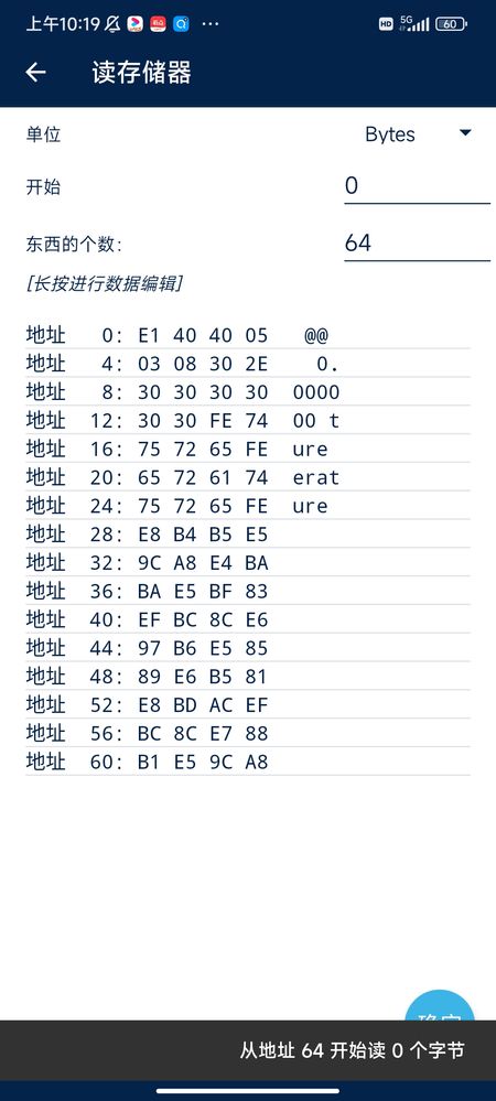

I have programmed the temperature sensor, but it seems that it has not been successful, the NDEF reading result is shown in the figure, what should I do?
if( NfcType5_NDEFDetection( ) != NDEF_OK )
CCFileStruct.MagicNumber = NFCT5_MAGICNUMBER_E1_CCFILE;
CCFileStruct.Version = NFCT5_VERSION_V1_0;
CCFileStruct.MemorySize = ( ST25DVXXKC_MAX_SIZE / 8 ) & 0xFF;
CCFileStruct.TT5Tag = 0x05;
/* Init of the Type Tag 5 component (M24LR) */
while( NfcType5_TT5Init( ) != NFCTAG_OK );
/* Init done */
NFC07A1_LED_Off( GREEN_LED );
HAL_Delay( 300 );
NFC07A1_LED_Off( BLUE_LED );
HAL_Delay( 300 );
NFC07A1_LED_Off( YELLOW_LED );
HAL_Delay( 300 );
/* write text message to EEPROM */
K_Temperature= MAX6675_ReadTemperature(); //读�?�热电�?�温度值
HAL_Delay(1000);
// 将浮点数转�?�为字符串
char temp_str[20];
sprintf(temp_str, "%f", K_Temperature);
// 将字符串转�?�为无符�?�8�?整数数组
uint8_t temp_data[strlen(temp_str)];
memcpy(temp_data, temp_str, strlen(temp_str));
// 写入NDEF消�?�
NDEF_WriteNDEF(strlen(temp_str), temp_data);
//读�?�NDEF消�?�
NDEF_ReadNDEF(temp_data);
/* Set the LED3 on to indicate Programing done */
NFC07A1_LED_On( YELLOW_LED );
2023-04-26 5:27 AM
as already explained in a previous post:
when the NDEF TEXT message is properly formatted, Android displays the text (i.e. decodes the NDEF and extracts the payload). If using the ST25 NFC Tap app, the NDEF tab display "Text record"; the content of the record is displayed when pressing on the "Text record" field.
This is the way you should check.
Rgds

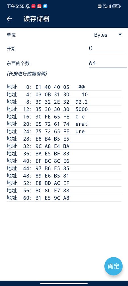

2023-04-24 1:01 AM - edited 2023-11-20 7:24 AM
Hi,@Brian TIDAL_O
I am a beginner,so can you give me more information about NDEF_WriteText API?I read out the memory through the following code as shown in the image,but I don't know why is it displayed like this?I need your help�?Thanks

2023-04-24 2:42 AM
in a nutshell, an NDEF message is a set of NDEF records. Each NDEF record carries a payload identified by a payload type (e.g. TEXT, URI, etc.).
NDEF_WriteNDEF is designed to write a buffer containing an NDEF formatted message. In your case, the content of NDEF_WriteNDEF buffer is not an NDEF message but the payload with the temperature value as a text. As the temperature value is a text, the proper API to be used is NDEF_WriteText (see description inside lib_NDEF_text.c). NDEF_WriteText encodes the payload into a TEXT record and then writes this NDEF buffer thanks to NDEF_WriteNDEF.
What you currently have in the tag memory is:
block 00: E1 40 40 05: Capability Container
block 01: 03 0B 31 30: NDEF TLV (T=03h, L=0Bh, V= 31 30 39 32 2E 32 35 30 30 30 30 etc.)
block 04: xx FE xx xx : Terminator TLV
Here the V-field (31 30 39 32 2E 32 35 30 30 30 30) is the payload whereas it should be the encoded TEXT message. If you use NDEF_WriteText, the V-field will have the proper TEXT message format
Rgds
BT
2023-04-24 6:06 AM
Hi,@Brian TIDAL_O
According to your words, I have got the temperature data correctly,So I just have to watch the V-field to get the temperature data,Is that so?
2023-04-24 10:28 AM
The memory content will be:
block 01: 03 11 D1 01: NDEF TLV (T=03h, L=11h,
block 02: 0D 54 02 66 V=D1 01 0D 54 02 66 72 31 30 39 32 2E 32 35 30 30 30)
block 03: 72 31 30 39
block 04: 32 2E 32 35
block 05: 30 30 30 FE: xx xx xx FE Terminator TLV
V-field decoded:
D1 Record header, TNF=001
01 Type Length
0D Payload length
54 Type: T (Text)
02 66 72 Text lang = en
Text = 1092.25000Rgds
BT
