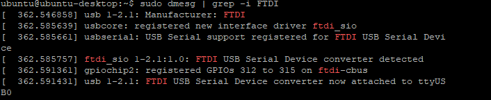

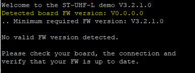

2024-07-22 5:45 AM
yes sir, i've alreadly checked usb devices in the command line and the board appear as FTDI_FT231_USB_UART_DK0E4A01, but i received this when i run the .out file
2024-07-22 6:17 AM
when version is reported as V0.0.0.0 this normally indicates that the serial connection to the board failed.
could you please check all available USB to serial converts on your device and list their mount points with
dmesg | grep -i FTDI
could you also please share the STUHFL log from your out file to see the return value of STUHFL_F_Connect(..) by using
tail -f /var/log/syslog"

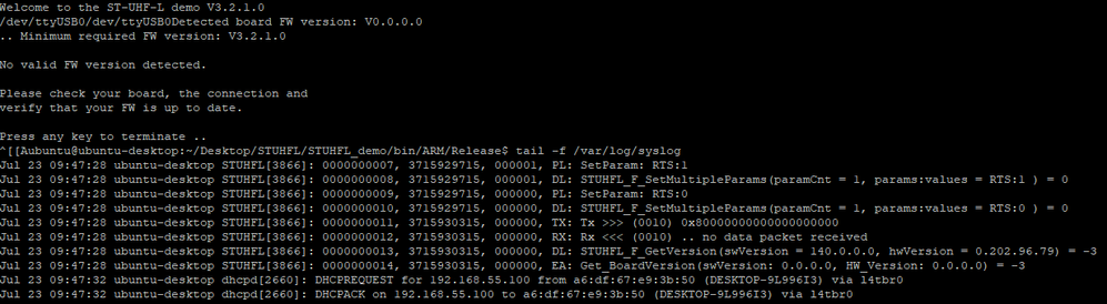

2024-07-22 7:53 PM
Hi, Mr.Nick
Here are all the logs you asked for, i don't really understand the error

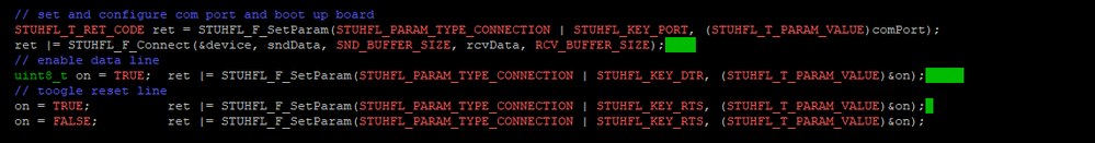

The STUHFL logs starts with the setup of the RTS lines.
Before this the log of line 125, 126 and 128 is missing, which connects to the board in STUHFL_demo.c and should give more info why the connect fails.

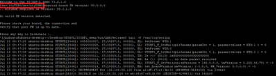

What is a bit strange in your screenshot of the terminal output is the following.
This should be "/dev/ttyUSB0". (only once). If you call STUHFL_F_Connect with "/dev/ttyUSB0/dev/ttyUSB0" the call will fail.
STUHFL_demo.c printf in line 264 the COM_PORT define. Have you added a additonal printf statement ?
Or have you modified the COM_PORT define in line 67, or any idea were this comes from ?

2024-07-23 1:23 AM
Hi Mr.Nick,
Thanks for the reply.
About the output, i did add some printf statement in the code, i will delete it later.
So I need to find out why the line 125, 126 and 128 isn't included in the code flow? Because these line is still in the source code, what do i have to do next?

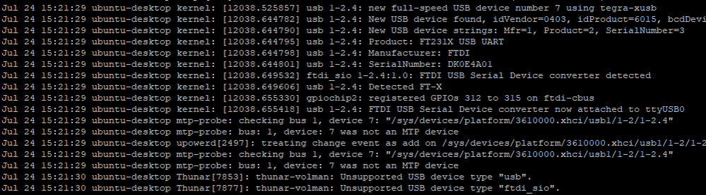

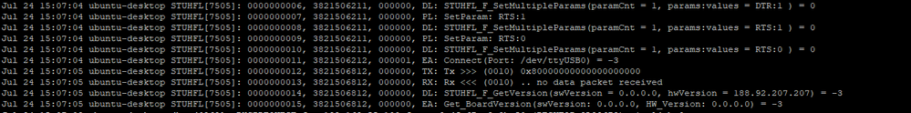

2024-07-24 1:15 AM - edited 2024-07-24 1:26 AM
Here is another one, please let me know if you have any solution, please.

Hi cuongnguyen,
thanks for the screenshots. As already assumed is the issue is the STUHFL_F_Connect function.
The call to the function seams to be using correct parameters.
The only change to find the reason why it is failing with your board is to debug the implementation.
For your linux board the relevant implementation could be found at
.\Middleware\clib\STUHFL\src\platform\stuhfl_bl_posix.c at function
STUHFL_T_RET_CODE STUHFL_F_Connect_Posix(STUHFL_T_DEVICE_CTX *device, char* port, uint32_t br)
One other thing to check is if your UHF board have enough power. Do you use a HPEV board and have connected the external supply ?
BR
2024-07-30 9:35 PM
Turn out that i did not set permission for the program to access serial device, thanks for debugging advice, everything works fine now, thank you so much
