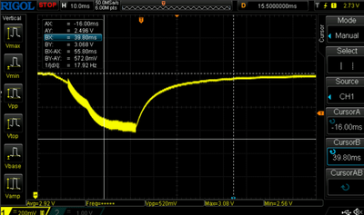

we're working with the ST25R3918-AQWT in a design that's powered by a CR2054 coin cell. We're trying to minimize the peak current draw through the NFC coil since right now we're seeing about a 500mV droop on VBAT during our NFC read.
We've already configured the output resistance to the highest setting but we're still seeing peak current spikes that are higher than we’d like. Our main concern is an effective reduction in battery life if the voltage droops enough to brown out the ST25R3918 whenever the field turns on. Are there any other settings or hardware design choices we can make to reduce the total energy used during an NFC read?

Changing the TX modulation to 5% and maximum driver resistance to max. did help already, reducing the drop by 100mV.

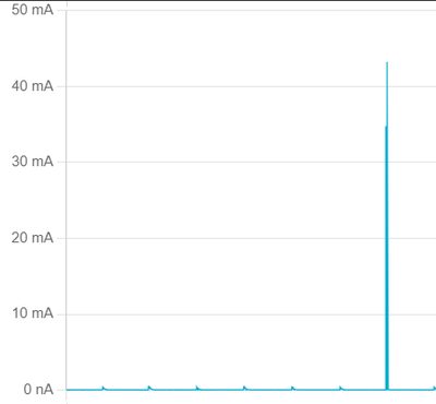

Current draw during the NFC read.
