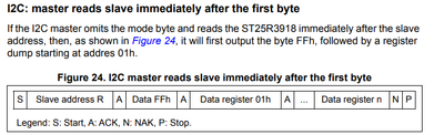

2025-05-12 7:45 AM
Hello Brian,
Thanks for your reply.
Yes I have checked the datasheet and tried also with this sequence:
so it seems mode byte is ommitted even though I set it

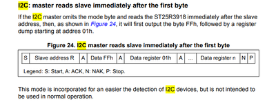

2025-05-13 12:15 PM
Hello BT,
Thanks for the suggestions.
Wire.endTransmission() returns 0 so it's ok.
I can read chip ID reg(0x3F) and any reg for ST25R3918 but only in this mode(when doing a dump of registers):
even though I send byte mode according to the datasheet and the Wire.endTransmission() afterwards returns 0(transfer completed)
