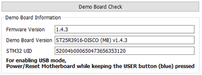

By other side, we have an Android App with a customized AID, already tested and working. It answers with 0x9000 when it receives the APDU containing the AID previosuly configurated. We have checked it with the ST25R3916 Discovery Board with the firmware version 1.4.3 (see following picture)
