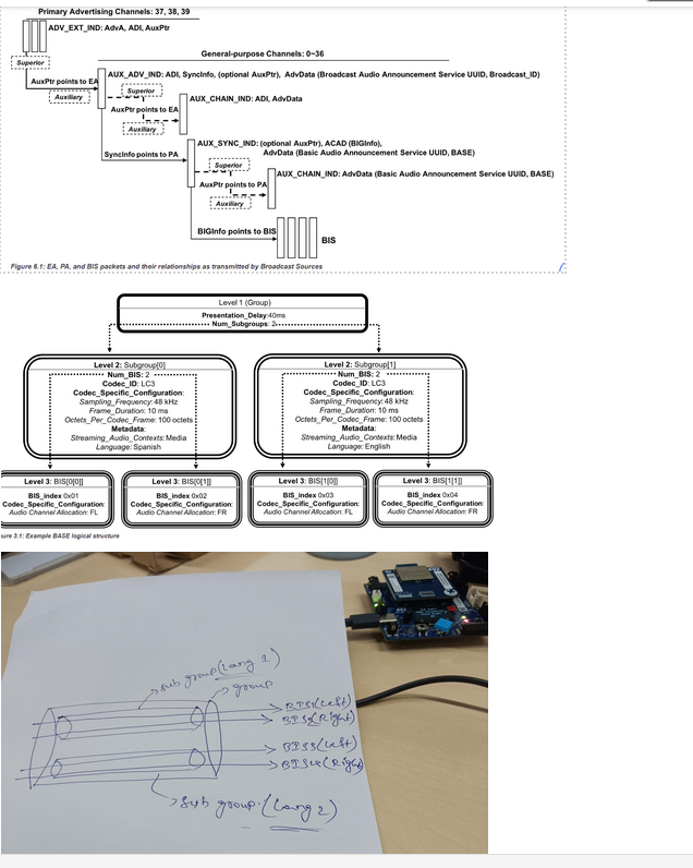

You mentioned Number of BIS = 4, with 2 subgroups.
Example breakdown:
Subgroup 1 → BIS 0 & BIS 1
Subgroup 2 → BIS 2 & BIS 3
The transmitter (nRF5340) is advertising 4 streams grouped into 2 subgroups.
The receiver (STM32WBA) must parse the BASE (Broadcast Audio Stream Endpoint) info and decide:
Which subgroup(s) it will sync to.
Which BIS index(es) it will actually receive/play.
It scans advertisements from the nRF5340 source.
Decodes the BASE → finds available subgroups and BIS indexes.
Selects BISes dynamically (you’ll need to implement Select_Suitable_BISes() correctly).
Then it synchronizes to the BIG (Broadcast Isochronous Group) and starts receiving audio.

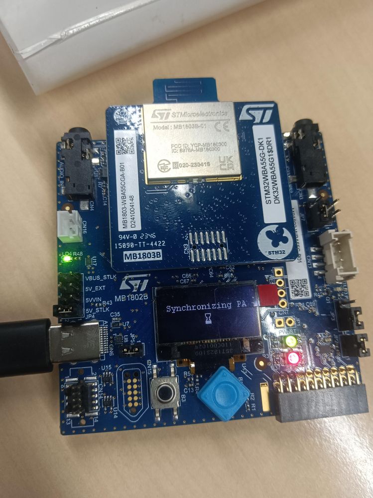

this is receiver side presently i am try to implement feature is once the receiver side will syn to transmitter then i need to select the bis audio has the oled display menau showing select audio then the receiver side will play the audio

i am implementation for oled display to select the audio showing display

Hi Jeevan,
Just to clarify the situation:
Does this summarize your issue ?
If so, could you provide the full logs of the TMAP_Peripheral app when the problem occur ? Did you try to synchronize to the Broadcast Source with another nrf5340 Audio DK to ensure that the Broadcast Source is operational ?

Here’s a refined project summary that clearly explains your work and the BIS (Broadcast Isochronous Stream) part with English + Chinese subgroups:
Transmitter (nRF5340 Audio DK): Implemented BLE Audio Auracast Broadcast Source, configured with 2 subgroups, each carrying a BIS (Broadcast Isochronous Stream) — one for English and one for Chinese audio.
Receiver (STM32WBA55G-DK1): Developed TMAP Sink application to scan, synchronize, and subscribe to broadcast streams dynamically.
Dynamic BIS Handling: Integrated logic for dynamic BIS scanning, synchronization, and stream selection, enabling receiver-side choice of language stream.
User Interface: Designed OLED display + joystick-based menu for language selection (English/Chinese) and audio stream control.
End-to-End Demonstration: Successfully demonstrated real-time BLE Audio playback across Tx–Rx platforms, showing multi-language broadcast working via Auracast.
System Flow:
nRF5340 Audio DK (Tx: English + Chinese BIS) → Auracast Broadcast → STM32WBA55G (Rx) → OLED menu (Language Select) → Audio Out

Dynamic bis selection related to

Transmitter broadcasts BIG with multiple BIS indexes.
Receiver discovers BIG → gets BIS list.
Menu on OLED shows BIS indexes dynamically.
Joystick input updates selected BIS index.
Receiver calls CAP_Broadcast_StartBIGSync() with the selected BIS index.
Audio starts streaming from the chosen BIS.

When the receiver DK (STM32WBA55G) is scanning and trying to sync with the transmitter (nRF5340 Audio DK),
the OLED shows:
The receiver is able to detect advertisements from the transmitter, but it gets stuck at Periodic Advertisement (PA) sync.

But right now, the UI is not linked properly with BIS sync logic: i write
Here’s how it should work on OLED if things are correct:

The screen says that you are stuck at the Periodic Advertising Synchronization step but according to your logs that is incorrect. In your logs you can see "Success: CAP_Broadcast_StartBIGSync()" which in the original source code of the app would be followed by "Menu_SetBISSyncPage" that would update the screen to the next step. Is this function actually called in your project ?
Everything in the log is fine so I would say this is probably a display issue.

Can you please suggest me where to call "Menu_SetBISSyncPage" this function?
My nRF board is broadcasting successfully. But I got blocked at this stage.
Regards,

Got it. But my problem is It should display the Languages(BIS's) before synchronizing to the BIS. So that user can select the language, according to the selected language receiver can sync to that BIS. It is working fine if I gave the BIS's statically. How can I add the language menu on the display? to select by the user.
Regards,

You would need to understand and edit the app_menu_cfg.c file, which contains the user menu displayed on the LCD. You need to create a new page of type LIST, populate it with the languages available from your stream and assign actions to it. You can check how it is done for the p_broadcast_menu which is populated by the Broadcast Sources scanned and initiate synchronization when selecting an entry.
By the way, we are currently in the process of publishing a Github repository with 2 projects that fit your needs: a PBP Source with multiple languages and a TMAP Peripheral that synchronizes to one language and allows to switch between available languages. It should be available in a few weeks if you can wait until then.
