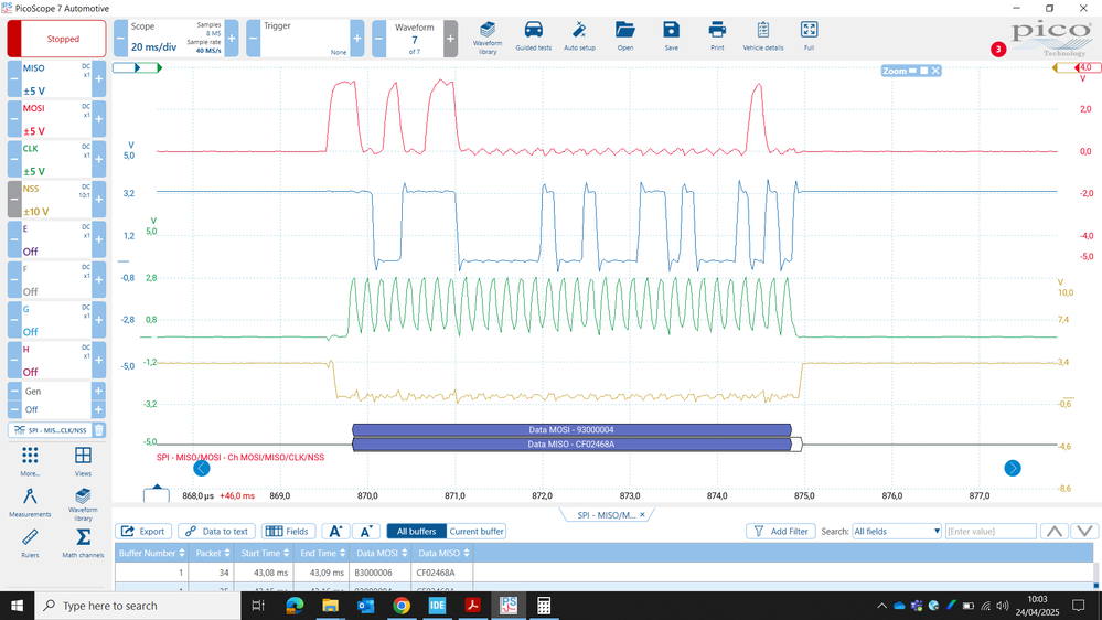

I'm currently trying to implement a SPI slave in full duplex mode on a STM32F469IDISCOVERY in order to interface with an external Master that is working at 10Mbit/s (the master cannot be modified). What I need to do is a full duplex communication by receiving a packet of 32 bits and at the same time responding with 32 bits that correspond the answer to the previous packet.
Those transaction happens in a "burst" of 6 transaction each every 25us , then some idle time in the order of ms and the transactions restart. During each transaction, 3 messages are sent by the master (0xA3000007,0xB3000006 and 0x93000004).
My idea was to use SPI in full duplex with Interrupt mode by relying on the HAL function HAL_SPI_TransmitReceive_IT(), since later I will be needing to add some elaboration in the meantime and I cannot keep the microcontroller halted for communications. I first started testing only the reception and everything works fine. Once I started trasmitting, I encountered some issue. My intent was to reply everytime to the master with a known sequence 0x12345678, but the result was shifted of 11 bits to the right in circular way as it can be shown in the oscilloscope trace below. If I'm using TransmitReceive the same thing is sent, but I'm not more able to read the result.HAL_SPI_Transmit_IT() waveforms

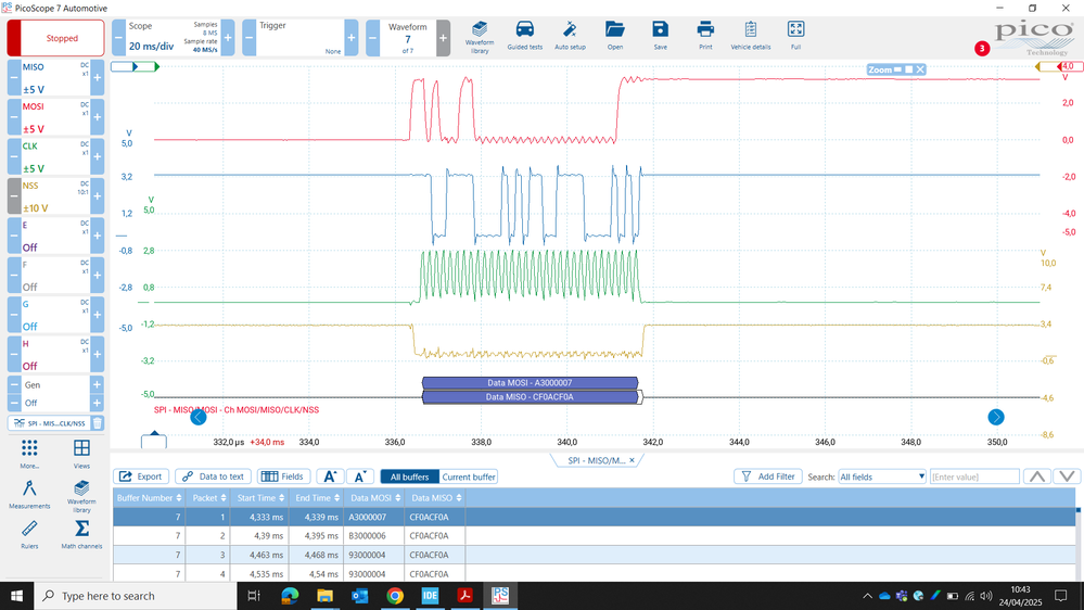

I tried the same with the DMA mode, for which I used the same communication settings and I was successfully able to receive the data. Again, when coming to transmission I encountered the same problem, but only the 0x5678 sequence is trasmitted and circularly left shifted by 5 bits, resulting in the sequence 0xCF0A repetead two times, as shown below for HAL_SPI_TransmitReceive_DMA(). In that case also the reading are shifted, and in particular I'm reading the end of the packet before (0xA3000007) with the start of the subsequent packet(0xB3000006) combined in 0x0007b300, which then is shifted to the left.HAL_SPI_TransmitReceive_DMA() oscilloscope trace
