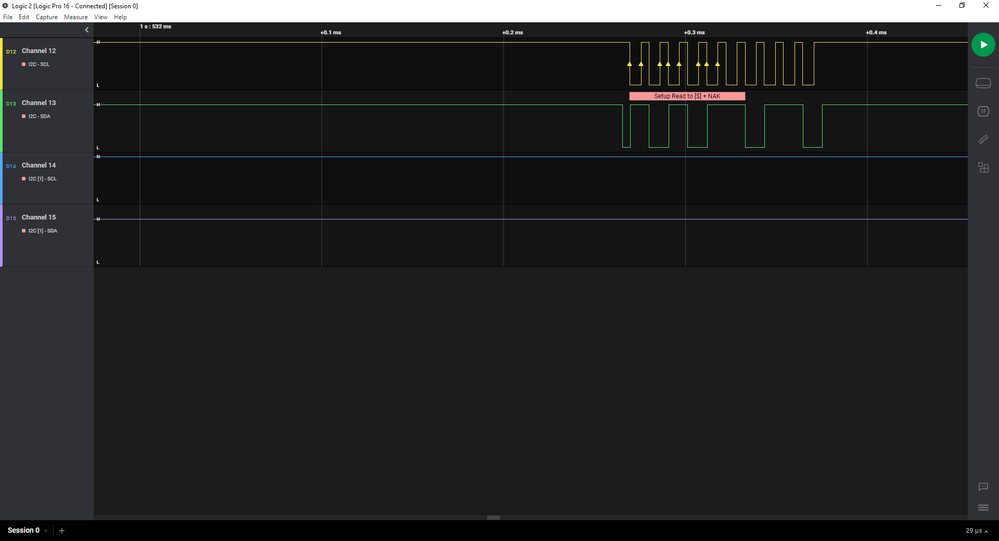

First, I send byte 0x52 to select I2C mode. Then I send bytes to select NFC app and the problem is when I try to read M24SR answer, it always send me a nack answer.
My code :
/* kill RF, select I2C */
HAL_I2C_Master_Transmit(&hi2c2,(NFC_ADDR_7BIT | WRITE_NFC),selectI2C,sizeof(selectI2C),TIMEOUT_NFC);
HAL_Delay(1);
//select NFC app
HAL_I2C_Master_Transmit(&hi2c2,(NFC_ADDR_7BIT | WRITE_NFC),selectNFCApp,sizeof(selectNFCApp),TIMEOUT_NFC);
HAL_Delay(1);
HAL_I2C_Master_Receive(&hi2c2, (NFC_ADDR_7BIT | READ_NFC), tab_nfc, 5, TIMEOUT_NFC);I'm doing something wrong, but I don't know what. If you have some ideas.

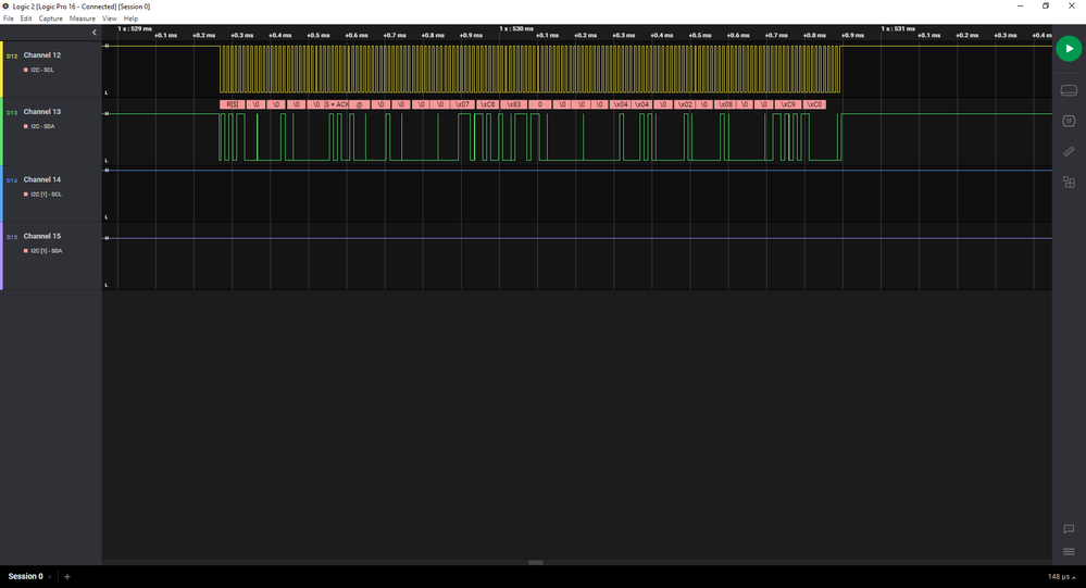

2022-11-08 5:01 AM
not an expert m24sr but I presume that analysis will be easier if you set I2C decoder to hex mode and possibly share the trace itself.
Best Regards, Ulysses

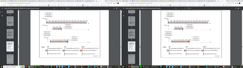

2022-11-09 5:21 AM
By checking the datasheet, the last byte of reading operation is NACK, so that's normal.
I've also modify my way to read by adding function "HAL_I2C_IsDeviceReady", now it starts to work better.
