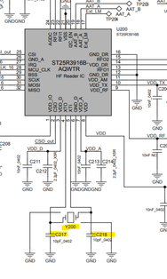

In the STEVAL-ST25R3916B schematic the "HSE" xtal [Y200] shows 2x 10 pF loading capacitors [C217, C218] connected [see snip from STEVAL-ST25R3916B pg. 20].
The bill of materials also lists Y200 + loading capacitors to be installed.

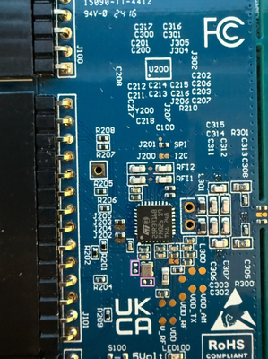

While visually inspecting the board... I noticed that [...what I believe to be...] the loading capacitors [C217, C218] were not populated. Under microscope I could see trace connecting the capacitor to the xtal. I ended up removing the loading capacitors from my design to more closely match the eval board.

could you send a picture of the area around the Y200 which should have the missing caps, please. You can use a mobile + zoom if you don't have a good possibility with your microscope.
I am puzzled, not aware of such an issue. To my understanding the caps should always be mounted.

I took a quick photo with my phone. I will have access to a microscope this afternoon if you'd like a more zoomed in view. In the photo below I put a light purple box around the 2x footprints that I believe to be the loading capacitors.

Hi Spencer,
thx. Yes, these are the crystal caps. It looks as if there was an issue during production of the boards - they might have only weakly mounted on one side and then fallen off.
