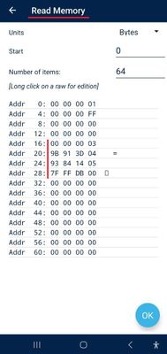

Im using the ST X-NUCLEO-NFC08A1 expansion board and i want to read the HEX Memory of a NFC-V Tag like the ST-Tab App..

The NDEF format is not correct, i know.
Thats why i need to modify the code to make a RAW Memory Data read.
Does somebody know what functions i can use with the RFAL or what needs to be modified to archieve that?

the RFAL provides a rfalNfcvPollerReadSingleBlock() and a rfalNfcvPollerWriteSingleBlock() API.

For that Arduino Sketch i used the ndef.ndefPollerReadBytes() function.
That works perfectly for what i need.
