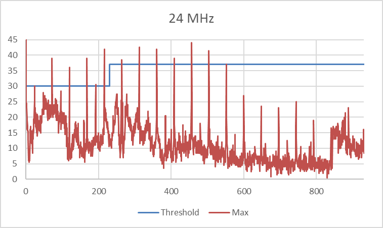

Hello DTomi.1
OK will check the data and revert. We are currently measuring as per CISPR32 Standards.
30MHz to 1GHz.
We have checked the setup by enabling and disabling the SDIO peripheral. By disabling the SDIO peripherals emissions are drastically reduced and are under the threshold values of CISPR 32 Standard

2023-05-18 6:15 AM - edited 2023-11-20 6:53 AM
We are using RF-explorer with 15mm H probe, (Near field antenna) for inhouse testing. (in closed environment)
and also we had observed same reflections in EMI lab, with +/- some amplitude
we are using ST MCU in multiple products, and every product have same issue.
if we disable SD clock then no harmonics observed.
is there any specific layout ? guide for SD clock?
