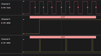

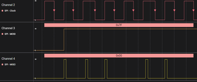

When I use the NFC08A1 program with the Steval, the reader works fine. But when I use the NFC06A1 example with the Mikroe board it doesn't work. When I try to read the chip ID in the initialisation process, it always reads zero. I have checked this interaction with a logic analyser in both examples and have attached the screenshots. I have tried both SW examples on both boards (I changed the reader/HW define in the compiler/preprocessor options so naturally, it should work). Both examples work on the Steval and both do not work on the Mikroe.

I didn't connect both GND pins before (only pin 8) but changing that didn't make much difference. I checked again with the logic analyser and now I get some more high flanks during the first byte transfer as seen below. But I don't the the same results every time and it still reads 0 as it gets low before the trailing edge of the clock. I also checked the ID value while debugging and it also gets 0 every time.

There should have no activity on the MISO when the host is sending the 7Fh. Thus the logic analyzer traces are abnormal. Have you tried with another Mikroe board?
