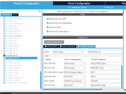

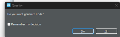

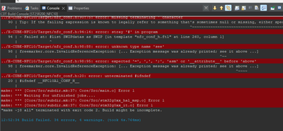

hi,
I tried using the X-CUBE-NFC10 package ,
but the package doesn’t build the project well,
This is my steps:

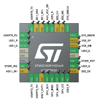

1-Configuration hardware I took from steval-25r200sa :

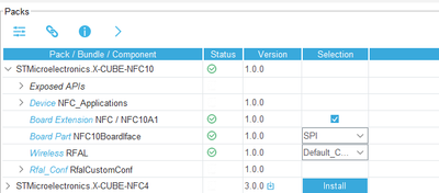

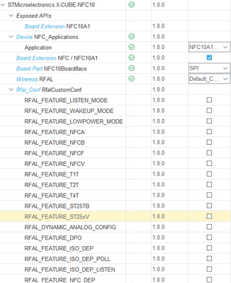

2- Configure the x-cube-nfc10
3- Enable the nfc 10 :
4- Generate code :
5- Build :
6- Adding nfc_conf.h , I copy into nfc_conf.txt:
this is my steps, what did i do wrong ?

2025-03-19 1:39 AM
make sure to follow the various steps described in STMicroelectronics.X-CUBE-NFC10_GettingStarted.pdf (available in <yourHomeDir>\STM32Cube\Repository\Packs\STMicroelectronics\X-CUBE-NFC10\1.0.0\Documentation)
In particular:
and

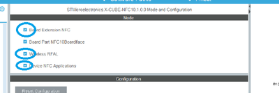

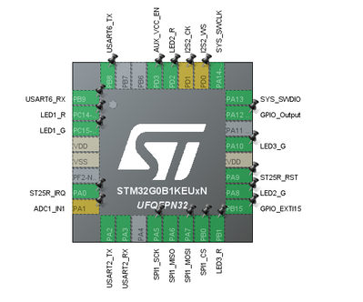

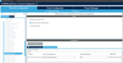

2025-03-19 6:07 AM
Hi
Thanks BT for your reply,
so i created a new project .
i took the .ioc file from steval -25R200SA evaluation board FW.
i created the project from the nfc10 :
i defined all missing HW (button EXTI and LED)
generate the project:

2025-03-19 6:48 AM
check your SPI configuration and make sure the Reset pin of the ST25R200 is low. The st25r200CheckChipID fails due to no reply on the SPI (i.e. no reply ==> 0x00 is read on the MISO), so either the Reset pin is floating or the SPI configuration is incorrect.
