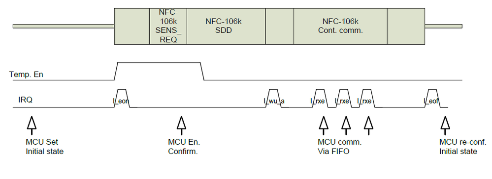

quite some work if you want to implement all this on your own. A very simple flow would look like this:
Initially put the 3916 into correct bitrate detection mode with automatic answers enabled and interrupts enabled. After receiving I_eon, the MCU needs to confirm operation within 10ms. Then the device will handle Anticollision/SDD autonomously. Next frames which may need to handled are RATS and potentially HLTA.
For actually getting recognized by a phone more actions are likely required: Proper handling of HLTA, proper handling of RATS and likely even proper handling of ISO-DEP protocol (R(ACK)/R(NAK handling for presence check). Full ISO-DEP is then required to present an NDEF to the smartphone.
