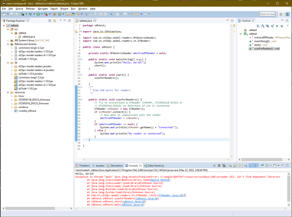

Hi! I am attempting to use the current 1.10.0 Java SDK on a windows 10 pro computer with JDK 1.8.0_144. (Java 8) x86 - for use with ST25R3911-DISCO at first, and hopefully then the Feig USB reader.
I have carefully followed the st25pcdemoapp_...pdf document as well as created my own simple demonstration [pictured] and gotten the same result: "streader.dll: Can't find dependent libraries"

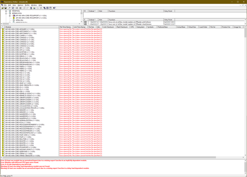

I have found the 2020 post with the same issue, and the linked zip file does not fix the problem. I have now used dependency walker to attempt to hunt down what is missing, which can be seen in the attached screenshots.
It appears there are a bunch of windows 10 SDK dlls that are not found, but I am so far unable to figure out where to find them to install them. The microsoft KBs appear to be for prior versions of windows.

Upon more research it appears those are not real errors, and the popular dependency walker program does not work with windows 10.

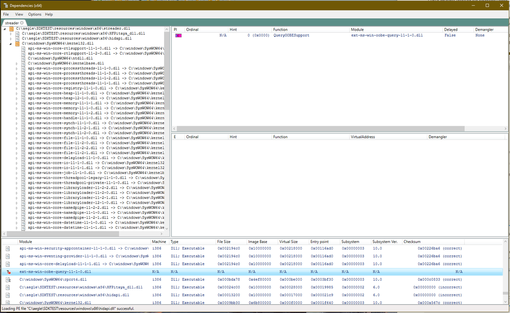

I have found a more modern program called 'Dependencies' that seems to indicate only "ext-ms-win-oobe-query-l1-1-0.dll" is missing - which maybe isnt what is causing my issue?
I am suspecting maybe this is a x86 vs 64 bit DLL issue? Thanks in advance.

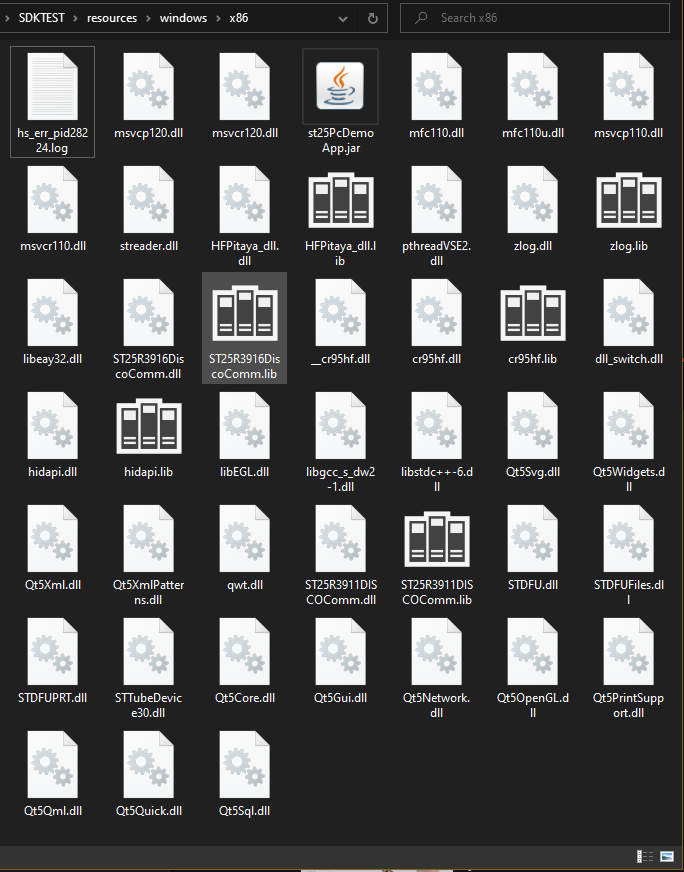

Thank you for the advice. Unfortunately I already had both MSVCP120.dll and MSVCR120.dll in the x86 resources directory.
I copied your files over the ones I had and still got the error. Below is an image with my entire system resources directory - anything missing?
