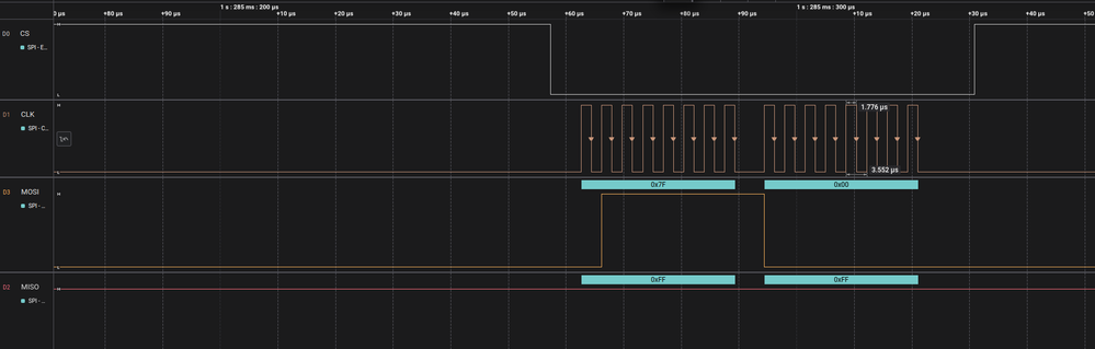

I was able to connect wires to SPI lines, and get the measurements to logic analyzer. These are the results:
Logic2 screenshot
Now i can see that the issue is the CS line, but i dont know why it is being changed to HIGH in these short pulses.

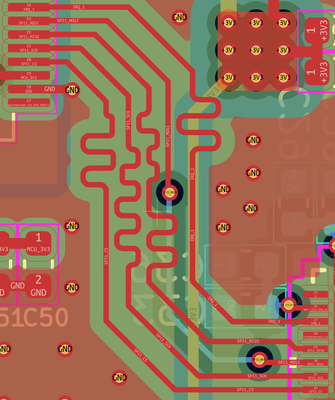

And the PCB Traces:

@qwdwdwwq wrote:Now i can see that the issue is the CS line, i dont know why it is being changed to HIGH in these short pulses.
Not just CS - it's also on MOSI
Looks like noise being picked up; try looking at it with your scope - in the analogue domain.
What's with the wiggly bits on the SPI traces?
One wouldn't usually worry about equal trace lengths on SPI, but it does look like a good way to pick up interference...

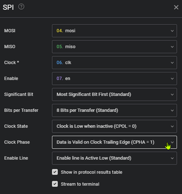

Ensure that the digital input/output voltage is set correctly, as this setting also adjusts the input logic threshold, which is approximately half of the VIO value.

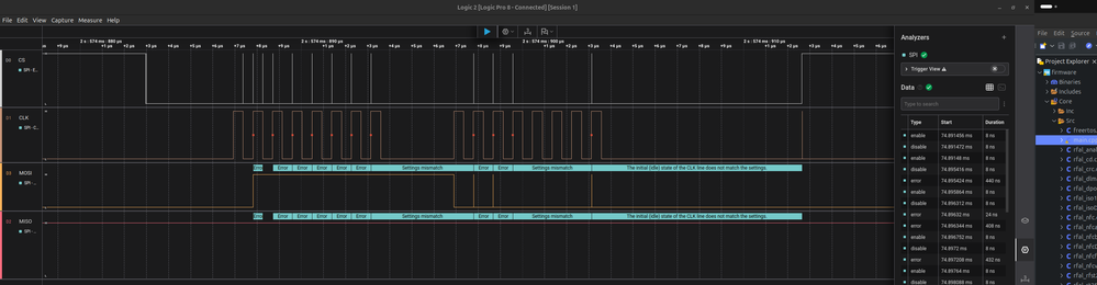

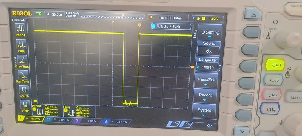

Thank you for help. I enabled the Glitch filter and the peaks are gone:

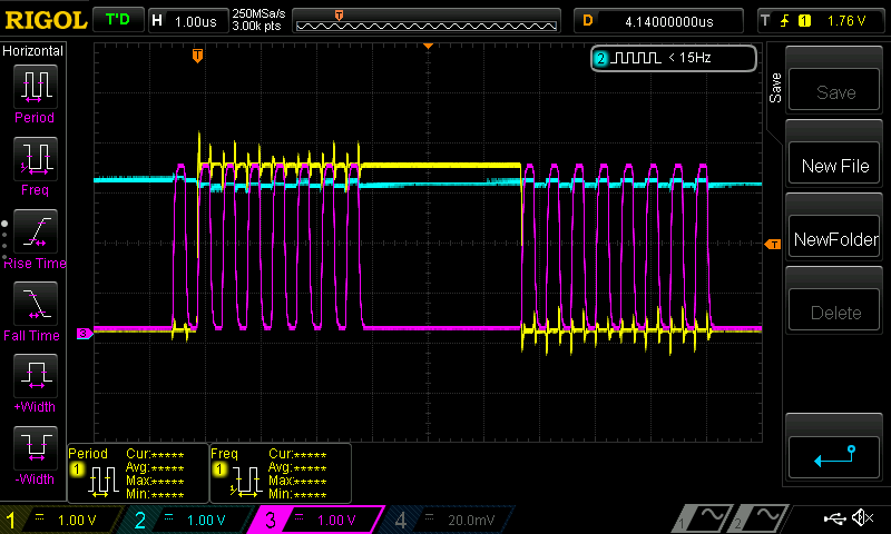

I also checked the CS line with the scope:

Please perform analog signal integrity on MISO line: Record at least two lines, best SCLK and MISO together to see the level on MISO when it should be driving a value.
2026-01-27 7:22 AM
Your scope has a USB socket for screen captures:
Please use it - it will give much better results than photographs!
(I'm sure you can also do it via the LAN connection)
2026-01-27 7:24 AM
@qwdwdwwq wrote:Thank you for help. I enabled the Glitch filter and the peaks are gone:
Of course - the whole point of a glitch filter is to filter-out glitches!
But that only filters them out from the LA display - it doesn't do anything to clean-up the actual signals on the board.
2026-01-27 7:32 AM
Yellow MOSI
Blue MISO
Purple SCK
