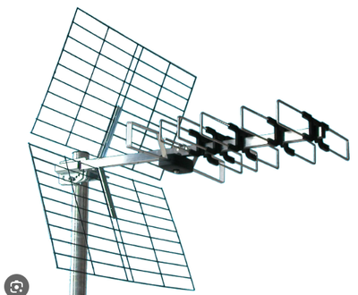

>when placed very close to a metal surface
What metal ? magnetic (steel) or not (copper, Lithium...as the battery is) ? with high loss or low impedance?
This might be the important point, try non magnetic and an LiPo near the antenna .
Also size and shape of the conductive area rel. to the antenna form and size is important,
to modify the 3-D form the field gets as result , not just being an absorber for the field.
Just think on the RF antennas, small difference in size makes a reflector or a director for a certain frequency:
...and the optimum distance to get the desired effect.
