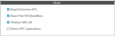

I've referred to UM3007 (Getting Started with X-NUCLEO-NFC08A1) and “Getting started with the X-CUBE-NFC6” documents.
I have installed the required X-CUBE-NFC6 software pack in STM32CubeIDE.
SPI1 is configured as per the documentation in .ioc .
However, after code generation, no SPI-related code is generated (e.g., no MX_SPI1_Init() function).
In the .ioc file's System View, the Middleware section shows nothing loaded — I suspect this may be part of the issue.

2025-07-02 4:38 AM
Hi @yeji_jang
welcome to this community.
As your IOC project does not select the Device NFC Applications, the main() function does not call any initialization related to the NFC middleware or initialize the IPs used by the NFC middleware (for example, SPI).
In this case, your application must call the initialization functions. For the SPI, the functions are available in custom_bus.c: just call SPI1_MspInit() followed by MX_SPI1_Init().
Next, your application must register st25r3916Isr() as the callback to the EXTI interrupt connected to the ST25R3916 IRQ pin. Alternatively, you can add a call to st25r3916Isr() in the USER CODE #1 section of the EXTI interrupt handler. If a NUCLEO-F401RE board is used, the ST25R3916 IRQ pin is likely connected to PA0, not PB13. I would suggest checking this point.

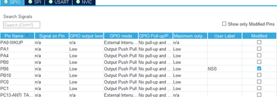

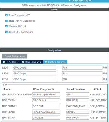

I carefully followed your suggestions and made the following changes:
I enabled the "Device NFC Application" in STM32CubeMX.
I configured SPI and EXTI interrupt settings correctly, and I also confirmed that the ST25R3916 IRQ pin is now connected to PA0 as advised.

2025-07-03 6:23 AM
Additionally, I’ve attached revised part in the latest version.
I manually added st25r3916Isr(); to the EXTI0_IRQHandler() function as shown below:
void EXTI0_IRQHandler(void)
/* USER CODE BEGIN EXTI0_IRQn 0 */
/* USER CODE END EXTI0_IRQn 0 */
HAL_EXTI_IRQHandler(&H_EXTI_0);
/* USER CODE BEGIN EXTI0_IRQn 1 */
st25r3916Isr();
/* USER CODE END EXTI0_IRQn 1 */
I’m wondering if I may have misunderstood something about how EXTI is supposed to be configured — and if so, I would be very grateful for any advice or clarification on what I might be doing wrong.

2025-07-03 8:09 AM
Thank you for your prompt reply.
I have already included "rfal_rf.h", and make breakpoint at st25r3916Initialize()
I found Initiatlization is failed, strongly assume that the ChipID is not properly read.
I’m currently seeing two related issues:
1.
ret = st25r3916ReadRegister(ST25R3916_REG_IC_IDENTITY, &chipID);
always returns chipID == 0x00
2. Inside demoIni(), rfalNfcInitialize() returns RFAL_ERR_HW_MISMATCH (–36), which indicates that the IC ID check failed.
Would you mind taking a moment to review my SPI initialization and GPIO configurations to see if there’s anything I may have overlooked? I would greatly appreciate any guidance or suggestions you could offer.
Thank you very much for your help!
