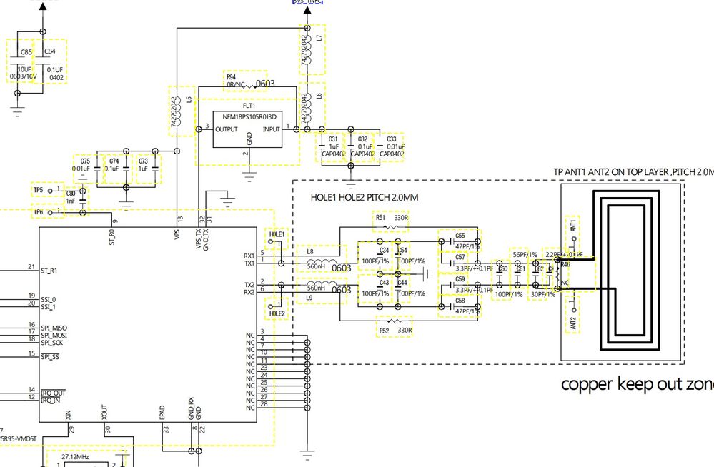

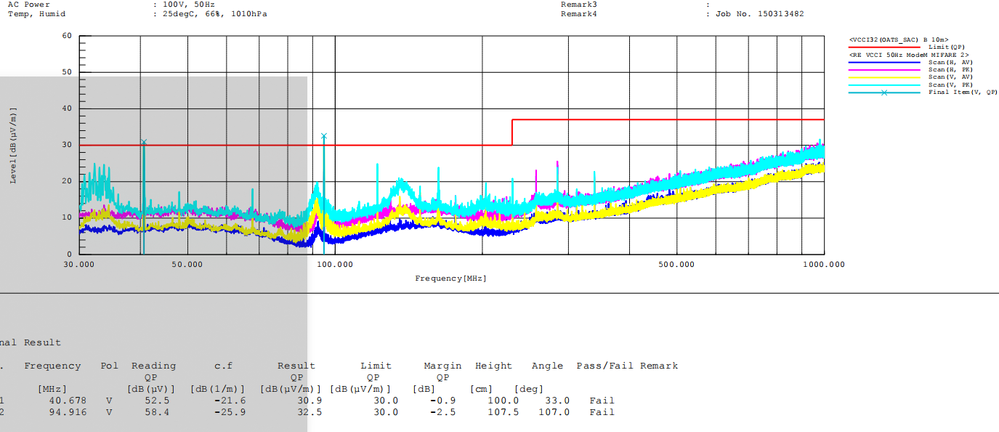

I am using the ST25R95, following the application note and matching tool to define LC components for EMC filter and matching circuit. the function test is good, but I have a high pulse at 3rd harmonics 40.8MHz and 7th 94.92MHz, do you have similar case happens with emission issue?

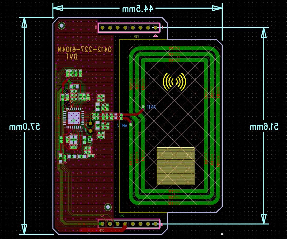

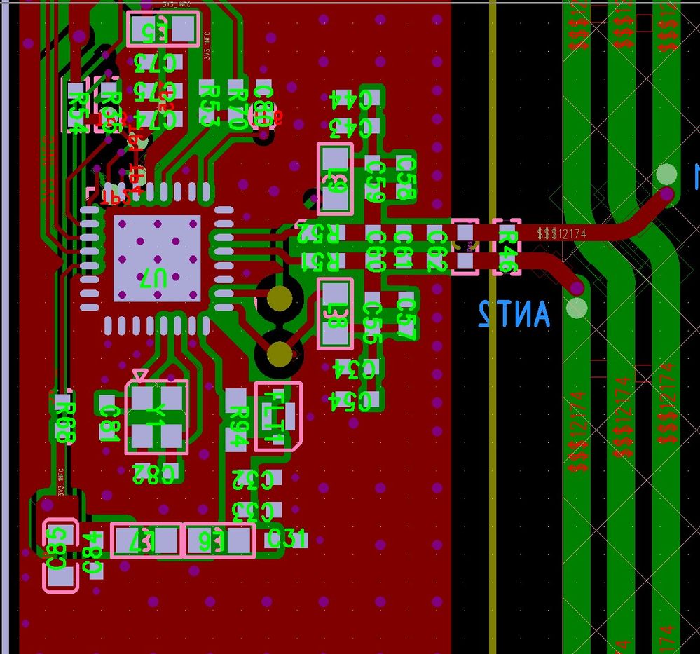

Could you also share the layout related to the NFC part.
It would also be interesting, if you change supply filtering what the resulting change in the spectrum would be.

I will check all voltage tomorrow, please check my layout first

first I would like to highlight that the ST25R95 is NRND. There is an Applicaton note AN6143 available to help migrating your design from ST25R95 to ST25R200.
Which standard are you measuring against? The spectrum mask looks different from FCC or CE.

I think it‘s VCCI standard. OK, I will wait for your responding.

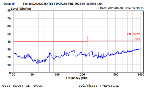

BTW,I update some test data, the EMC data I posted before is come from our customer test ,we reproduced that test again,and find 7th harmonic is gone(maybe different test circumstance),but 3rd harmonic is still NG.
And we find that different cards(NFC tag)tested with our sample have complete different EMC performance.

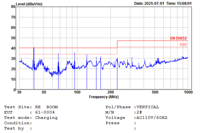

this is Mirfare 7 card result:
this is a Mirfare 4 card,40.7MHz keeps very low
why they behave so differently,it is due to NFC card performance?

Hello Jeckson,
If the card is put in close distance / close coupling on the reader, it will receive the maximum power. Most cards have an internal limiter which is rectifying and limiting the received voltage. Dependent on how this limiter is inside the card is designed, it can produce more or less harmonics. This is something the reader has no influence, since the hard is cutting off the tips of the sine and therefore creating harmonics.
You can try to improve the placement on the reader and the distance between reader antenna and card antenna.

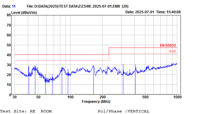

Hi Travis
this is the data without a card,40.7 and 94.9 MHz are almost same with background

Hello Jeckson,
as you highlighted above, the reader on its own is perfectly fine, but different cards can cause, based on how the card is designed, distortions in the magnetic field and causing harmonics. Selecting the correct card might be the solution.
I would recommend to provide your customer a fixed setup, a specific card glued at a specific position on the antenna.
