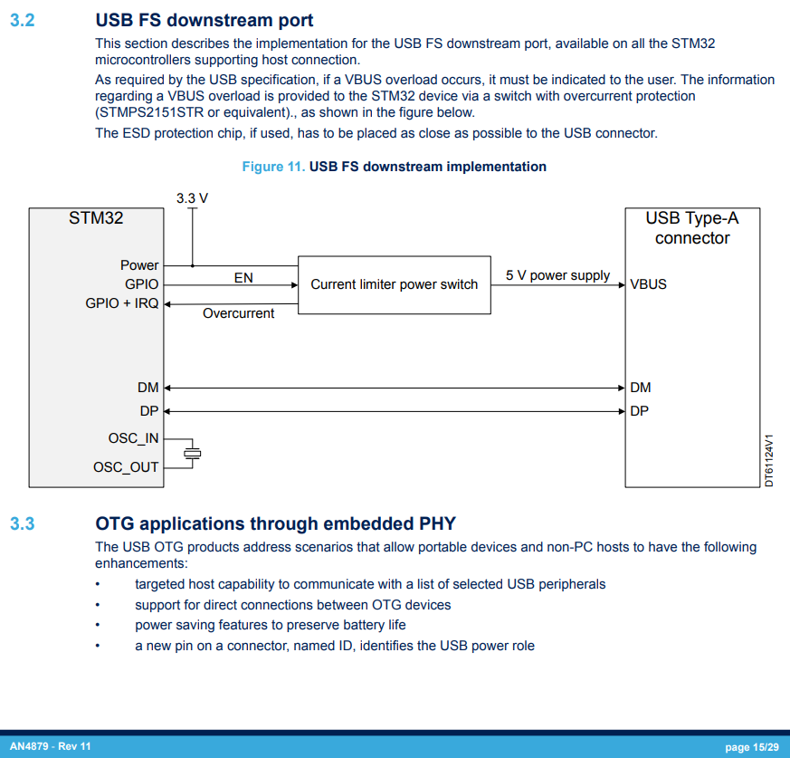

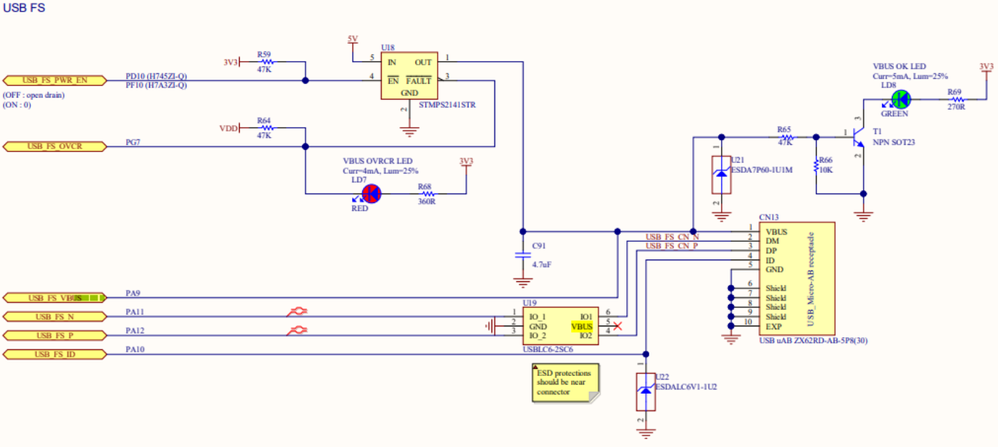

When STM32 is configured as host you need to configure a pin as output to power the device. You can use one of our reference boards schematics as reference.
Caution: Voltage on all STM32 pins must not exceed 4V against VDD, even when the MCU is not powered.
For the barcode scanner used, check whether it is bus or self powered, and provide the appropriate power supply/sensing accordingly.
2026-04-20 3:24 AM
USB is always 5V !
Take a look at Application Note AN4879, Introduction to USB hardware and PCB guidelines using STM32 MCUs:
