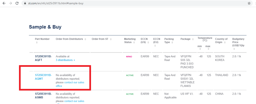

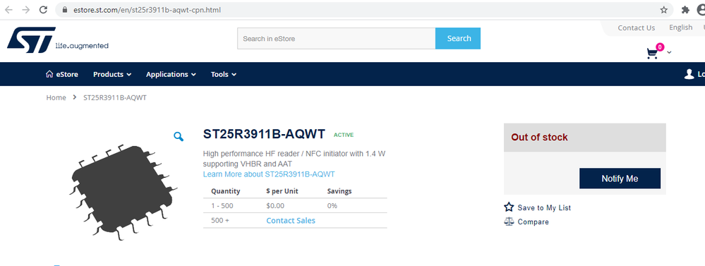

2021-02-26 1:47 AM
Thanks Peter for your response.
I have checked for ST25R3911B-AQWT but I have found that it is currently out of stock and there also no distributor for it.
I have also checked on major online distributors like mouser , arrow , element14 , but all of them don't have it in their stock.
