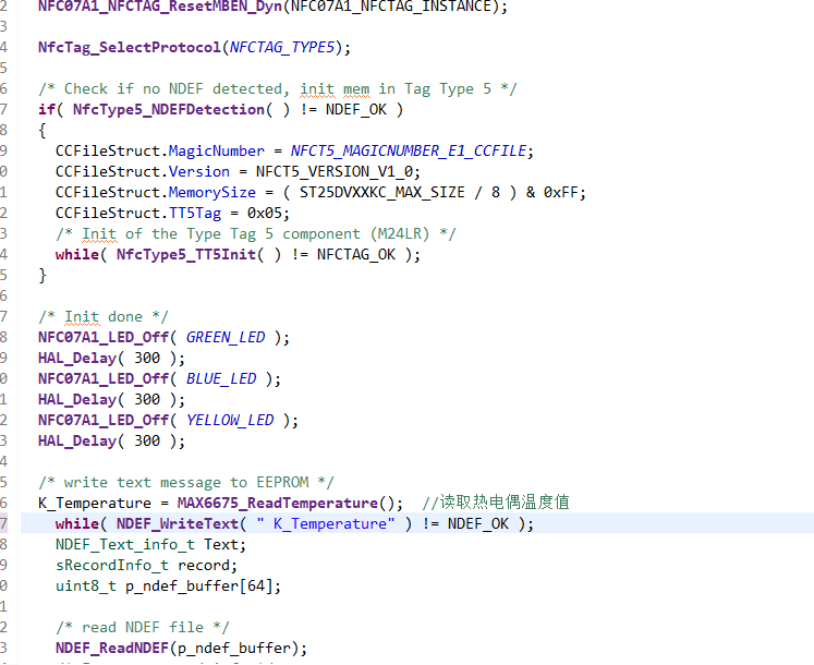

I want to read the sensor signal with NDEF_WriteText function,How do you read a temperature signal instead of a temperature text?
NDEF_WriteText funtion is printf funtion,so what should I do to read signal?

which demo are you looking at?
BR, Ulysses

Hi,@Ulysses HERNIOSUS_O
I am currently using ST25 to collect sensor information with NDEF, and I have written the code of temperature collection. For NDEF, how can I write the signal acquired by MCU into the label and read the real-time signal through NFC? What functions do we need?
2023-04-17 7:36 AM
of course you could create a text message "It has 27degC. Have a nice day!" out of the temperature of the sensor.
Or you look for a good NDEF record or mime or external type into which you want to code your data. This is up to you.
For some ideas you can look at https://developer.android.com/reference/android/nfc/NdefRecord
Best Regards, Ulysses

I can understand what you mean, and I gave my relevant code on how to write temperature data to NDEF instead of temperature characters.
void MX_NFC7_NDEF_URI_Init(void)
/* Configuration of X-NUCLEO-NFC02A1 */
/* Init of the Leds on X-NUCLEO-NFC07A1 board */
NFC07A1_LED_Init(GREEN_LED );
NFC07A1_LED_Init(BLUE_LED );
NFC07A1_LED_Init(YELLOW_LED );
NFC07A1_LED_On( GREEN_LED );
HAL_Delay( 300 );
NFC07A1_LED_On( BLUE_LED );
HAL_Delay( 300 );
NFC07A1_LED_On( YELLOW_LED );
HAL_Delay( 300 );
MAX6675_Init(); //K型热电�?��?始化
/* Init ST25DVXXKC driver */
while( NFC07A1_NFCTAG_Init(NFC07A1_NFCTAG_INSTANCE) != NFCTAG_OK );
/* Reset Mailbox enable to allow write to EEPROM */
NFC07A1_NFCTAG_ResetMBEN_Dyn(NFC07A1_NFCTAG_INSTANCE);
NfcTag_SelectProtocol(NFCTAG_TYPE5);
/* Check if no NDEF detected, init mem in Tag Type 5 */
if( NfcType5_NDEFDetection( ) != NDEF_OK )
CCFileStruct.MagicNumber = NFCT5_MAGICNUMBER_E1_CCFILE;
CCFileStruct.Version = NFCT5_VERSION_V1_0;
CCFileStruct.MemorySize = ( ST25DVXXKC_MAX_SIZE / 8 ) & 0xFF;
CCFileStruct.TT5Tag = 0x05;
/* Init of the Type Tag 5 component (M24LR) */
while( NfcType5_TT5Init( ) != NFCTAG_OK );
/* Init done */
NFC07A1_LED_Off( GREEN_LED );
HAL_Delay( 300 );
NFC07A1_LED_Off( BLUE_LED );
HAL_Delay( 300 );
NFC07A1_LED_Off( YELLOW_LED );
HAL_Delay( 300 );
/* write text message to EEPROM */
K_Temperature = MAX6675_ReadTemperature(); //读�?�热电�?�温度值
uint8_t data[] = "K_Temperature";
// 创建NDEF消�?�
NDEF_WriteNDEF(strlen((char *)data), data);
//读�?�NDEF消�?�
NDEF_ReadNDEF(data);
/* Set the LED3 on to indicate Programing done */

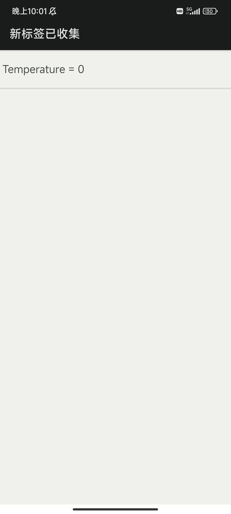

2023-05-10 1:34 AM - edited 2023-11-20 8:15 AM
Hi @帅 罗,
Please use the code snippet button to insert your code :This button is available below the "Write an answer" frame. This will facilitate readers' understanding and discussion.
Now about your question, you get the information from the MAX6675 that you store in the variable K_Temperature (this variable is not defined in the sample code you provided, so let's assume it is defined as an int32).
You want to write it to the EEPROM of the ST25DV as an NDEF Text message using the NfcTag_WriteNDEF function. To do that you need first to convert it from int to char before.
But your code
uint8_t data[] = "K_Temperature"; will not do the job.
One possible way to convert could be the following code for example:
char temperaturebuffer[30] = { 0xD1, 0x01, 0x1B, 0x54, 0x02, 0x65, 0x6E }; /* Header for NDEF Text */
/* Test Record Header */
/* 7 | 6 | 5 | 4 | 3 | 2 1 0 */
/* MB ME CF SR IL TNF */ /* <---- CF=0, IL=0 and SR=1 TNF=1 NFC Forum Well-known type, MB=1 and ME=1 1record only */
/* TYPE LENGTH */ /* <---- Type length = 1 */
/* PAYLOAD LENGTH 0 */ /* <---- Text message length */
/* TYPE */ /* <---- Type = "T" */
/* PAYLOAD */
K_Temperature = MAX6675_ReadTemperature(); //For example may return 10 for 10 degrees
sprintf(&temperaturebuffer[7], "Temperature = %d", K_Temperature);
NfcTag_WriteNDEF(sizeof(temperaturebuffer) + 1, (uint8_t *)temperaturebuffer);With it you should be able to read the ST25DVKC tag with a reader retrieving the information of the temperature, or reading with the MCU through the I²C.
Hope this can help you.
Kind Regards.
2023-05-10 7:07 AM - edited 2023-11-20 8:15 AM
Hi,@Rene Lenerve
I used the code as suggested by you,but my ST25 tap app only read temperature=0,please continue to help me to check the problem.

Hi @帅罗.1 (Customer),
Please edit your message and use the code snippet button to insert your code (your message is not really readable)
You handled to write an NDEF Text message into the ST25DV, your issue is now around the MAX6675 by reading raw value and converting it into temperature. One thing to check is if your variable K_Temperature is correctly declared. I can't see it's definition in the extract of your code or maybe missed as message is not correctly formatted.
One precision, this forum is about ST products, so if you have any question on how to use the MAX6675, please consider to post on MAXIM's forum your question.
Hope this help you
