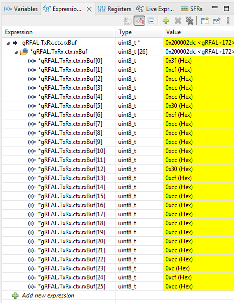

2023-03-29 12:58 AM
Hi Antonio,
0x3f would indicate that the tag is not doing a correct SOF (omitting the subcarrier pause: continued subcarrier). You could try making the rfalIso15693VICCDecode() more tolerant with respect to SOF but it would be good to understand the root cause:
Best Regards, Ulysses

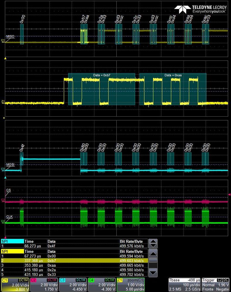

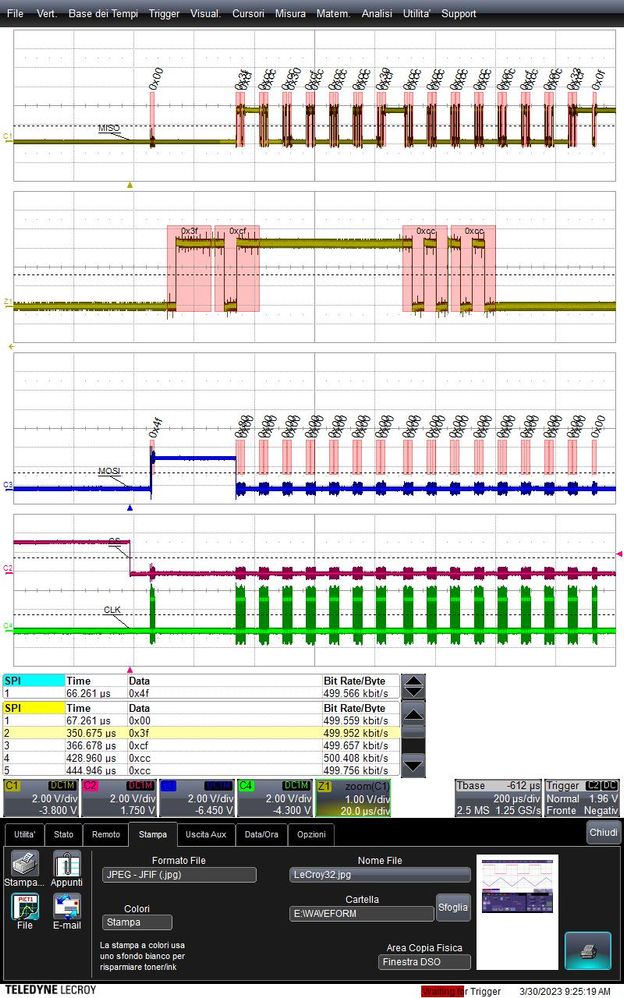

2023-03-30 8:23 AM
Hi Ulysses,
the problem happens in any position, i'm actually working with tag very close to transceiver antenna.
The tag shouldn't have boost feature (it is not specified in the datasheet) anyway the same tag works with 3911B.
I did a signal and register compare between 3911B (the reference) and 3916B (where i have the fault)
I both cases i triggered the scope to trace the byte transfer before st25r3916ReadFifo called by rfalTransceiveBlockingRx, immediately before rfalIso15693VICCDecode (where SOF is processed)
This is the scope trace with 3911B with SOF=0xb7 OK.
and this is the buffer (same byte sequence decoded by the scope OK)
This is the scope trace with 3916B with SOF=0x3f FAIL
and this is the buffer (same byte sequence decoded by the scope FAIL)
You can observe the the number of bytes written when reading from the fifo is higher than the 3911B case.

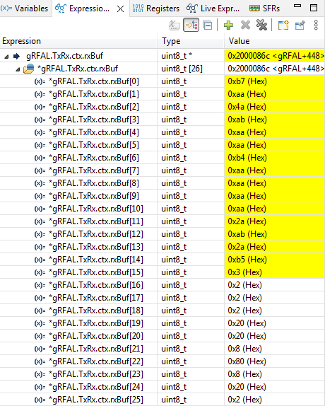

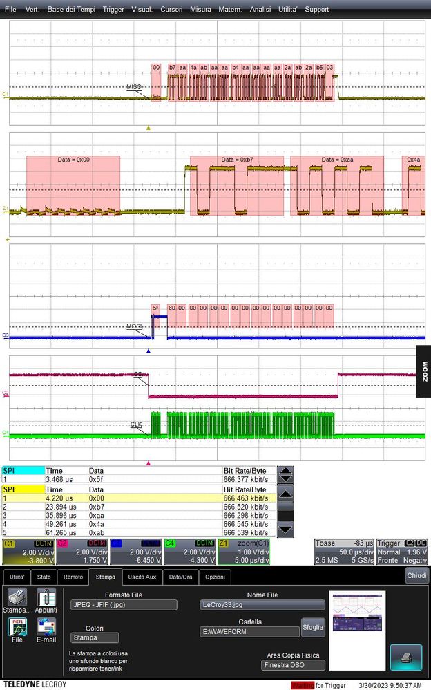

Just to have a reference 3916B when it is working, i did the same trace with a standard read command rfalNfcvPollerReadSingleBlock from block address 2. I called the function just before the point where the custom read fails.
The buffer start with the right SOF
Any suggestion?

2023-03-31 2:53 AM
Hi Antonio,
Looking at the received pattern it seems not a simple shift or damaged SOF:
3f cf cc cc cc 30 cf
11111100111100110011001100110011001100110000110011110011The sequence should have a SOF symbol of 11101 followed by only 01 or 10 symbols until EOF.
Did you by mistake set the two subcarriers request flag?
Otherwise you really need to look into the RF:
Field probe (connect the probe to the ground wire to build a small loop and put it between tag and reader antenna) and probe the CSI/CSO pins using described observation modes.
Which tag are you using? Something off the shelf? Similar for the reader: Is it one of our reader boards or something you did?
