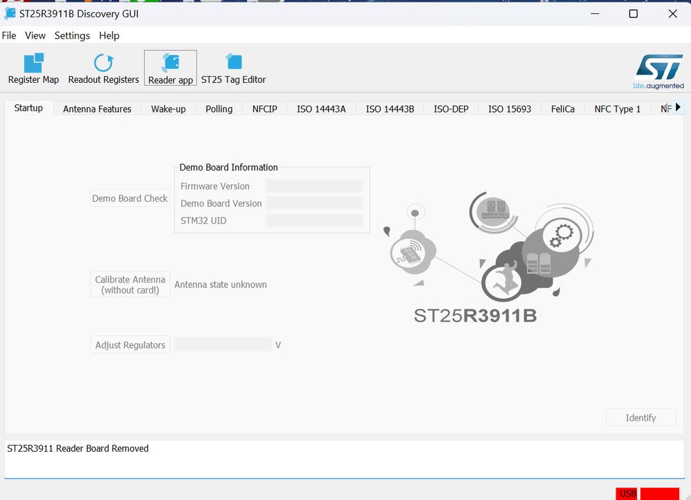

I connected these 2 kits in some PC but cannot connect to USB HID as shown in pictures
However when I unplugged the cable, the text "ST25R3911 Reader Board Removed" shown as in picture below.
The USB status always in red, no board detection.

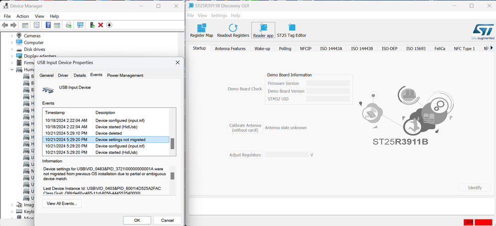

I search google for event "Device settings not migrated" and tried to fix all the methods,
eg. uninstall, remove device driver, scan pc, etc. Nothing work.

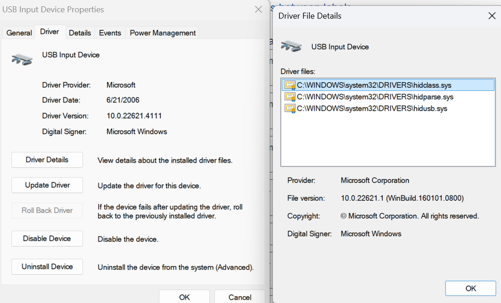

The windows 11 driver is shown in below picture

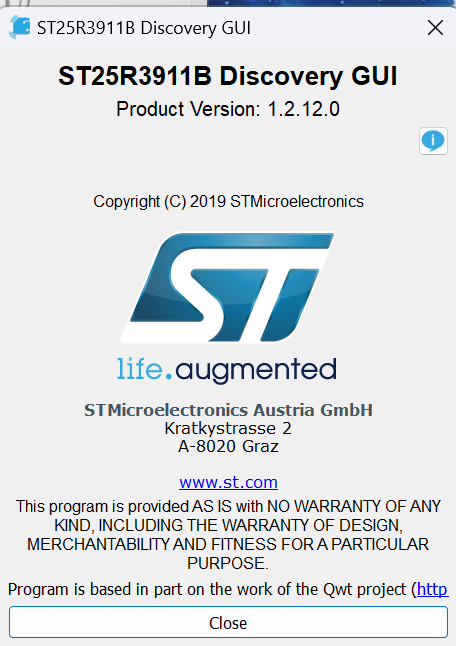

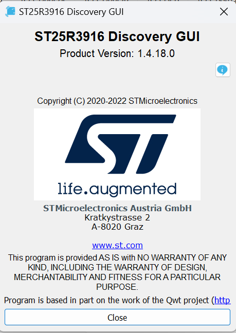

PC GUI for both kits were installed in latest version as shown below.
The same kits, the same cable connected to the same software GUI in another PC is OK
without "Device settings not migrated" event in Device manager.

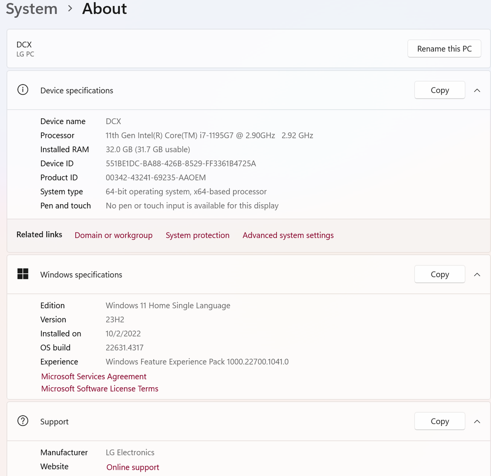

It's LG GRAM 17. Windows 11 Home since purchased.
And always updated to latest OS (now 23H2 OS build 22631.4317)
Another PC that's ok, no problem has the same 23H2 OS build 22631.4317 but Windows 11 Pro instead.
