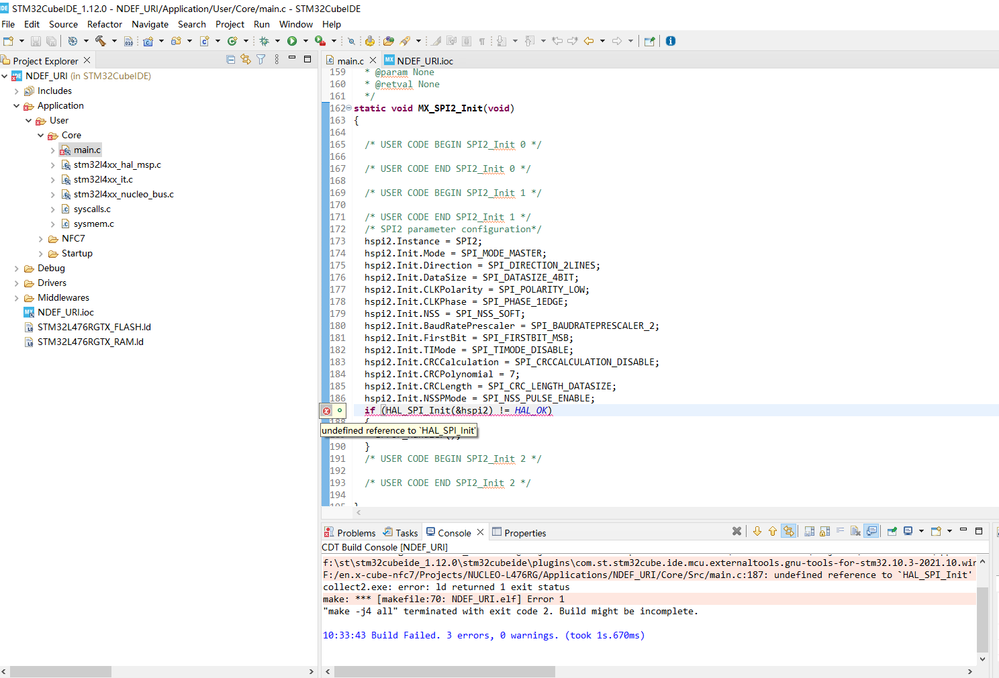

2023-04-03 7:30 AM

2023-04-06 6:06 AM
Obviously, stm32l4xx_hal_spi.c is not included in your project. I suggest to check.
Rgds
BT

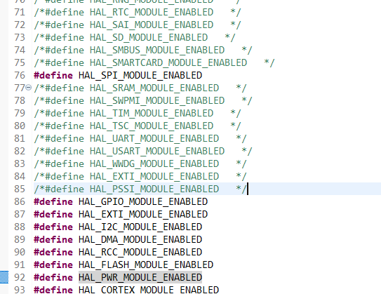

2023-04-03 8:42 AM
if I am not wrong, X-CUBE-NFC7 demos are delivered with an STM32CubeMX project file (.ioc file). It is not recommended to modify generated code but rather to use STM32CubeMX to add and configure peripherals. When regenerating the code, STM32CubeMX automatically updates the IDE project file (such as adding stm32l4xx_hal_spi.c and stm32l4xx_hal_spi_ex.c in the project file and defining HAL_SPI_MODULE_ENABLED inside stm32l4xx_hal_conf.h).
Make sure to have #define HAL_SPI_MODULE_ENABLED inside stm32l4xx_hal_conf.h and make sure to have stm32l4xx_hal_spi.c and stm32l4xx_hal_spi_ex.c in your project.
Rgds
BT

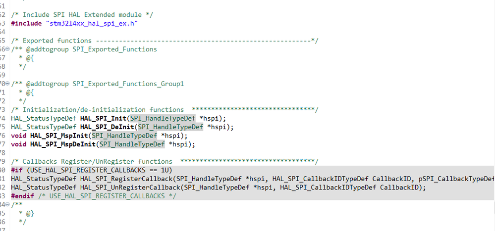

2023-04-03 7:31 PM
Hi,@Brian TIDAL_O
I have checked the relevant content and found no problem. stm32l4xx_hal_spi.c and stm32l4xx_hal_spi_ex.c in my project and able to jump correctly.I don't know what the problem is.

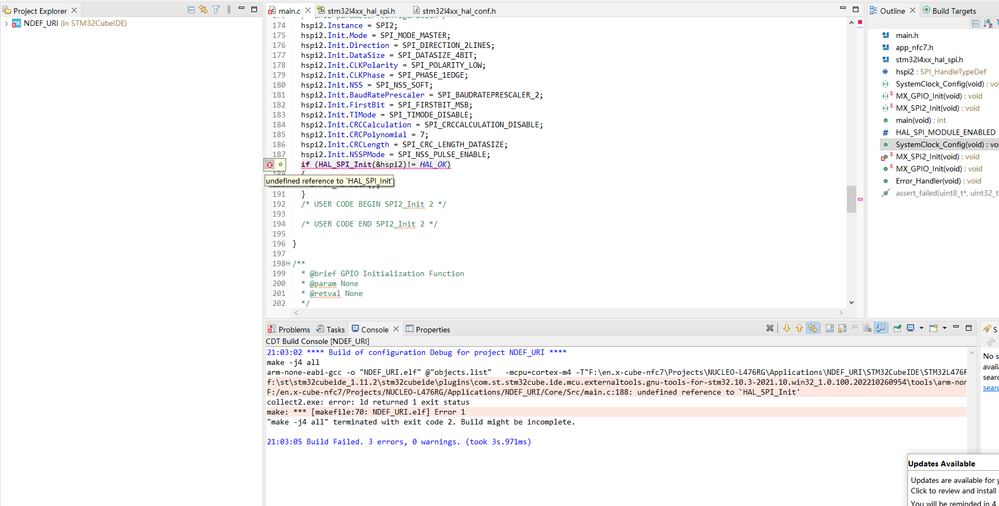

2023-04-04 12:12 AM
what is the exact output of the compiler/linker?
Rgds
BT
2023-04-04 6:06 AM
Here is the output of the compiler/linker,my code is from STM32 cubemx and make sure have stm32l4xx_hal_spi.c what should I do?

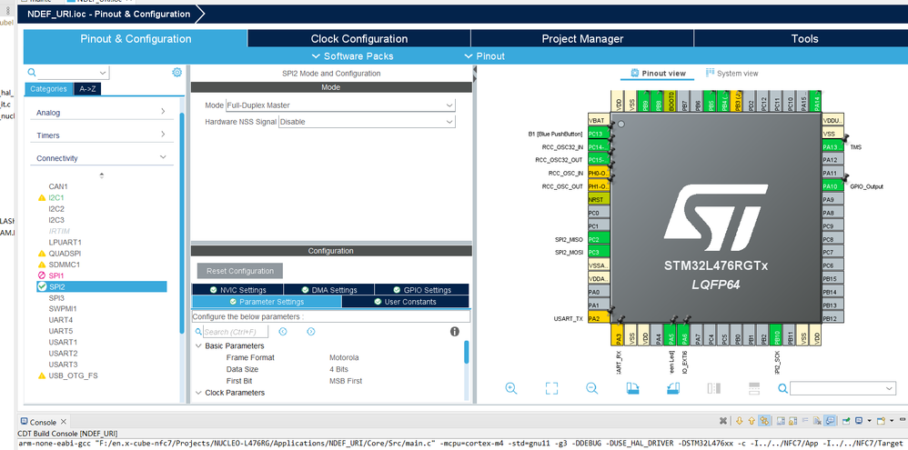

2023-04-04 6:37 AM
I believe there was an issue to regenerate the project while it was already opened/locked inside STM32CubeIDE. I would suggest to clean the project, close it, remove it from the workspace and re-import it.
Rgds
BT
2023-04-04 7:37 PM
I also think I have problem, but I don't know what should I do?

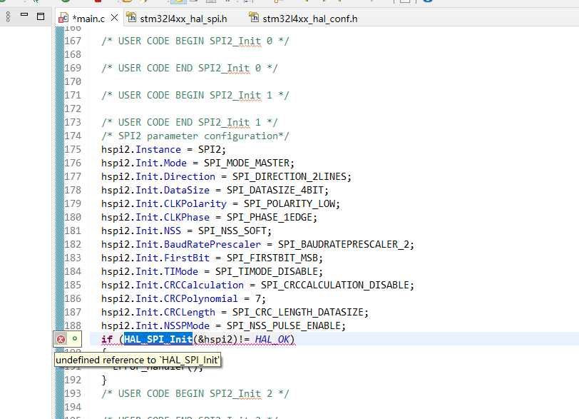

2023-04-06 6:06 AM
Rgds
BT
2023-04-06 6:28 AM
I check my project according to your advice,and run the codes successfully. Thanks!
