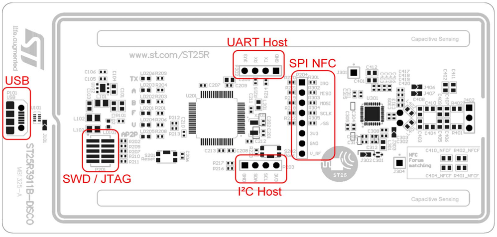

I working with 2 EVB for ST25R3911b: ST25R3911B-DISCO
the ST25R3911B-Disco Board have a 2 loop ~950nH (105 mm x 52 mm) antenna

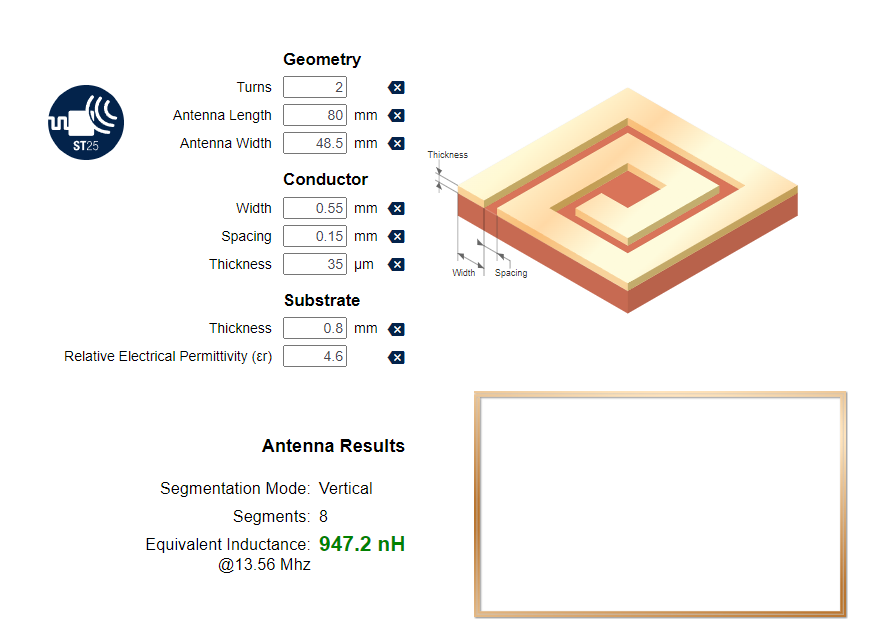

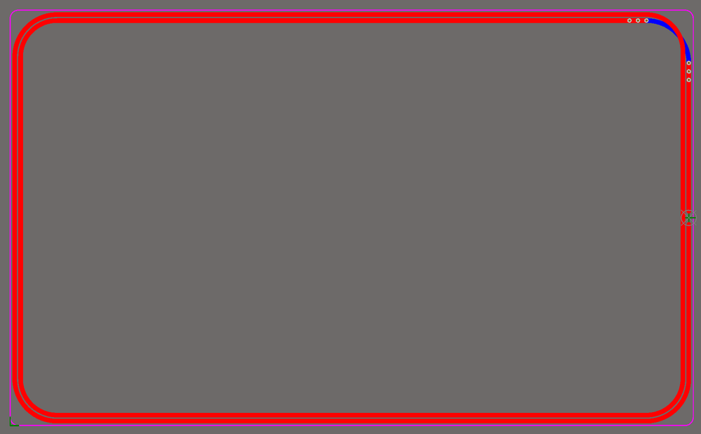

I tried to replace the antenna for a custom antenna ( 80x48.5mm ~940nH ) very similar to the ST25R3911B-Disco Board.
The Impedance is 947nH, according to eDesignSuite.

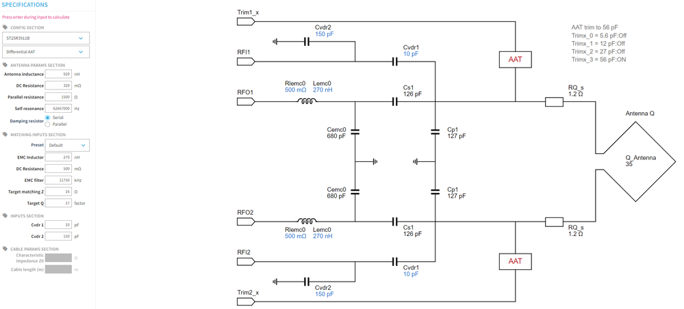

I tried to use the NFC Tuning Circuit, but because a don't have the exact parameters of the antenna so I tried to smart guess the rest of the parameters.
In result, the circuit just don't work at all, I connected the board to the software "ST25R3911b Discovery GUI" to measure the Antenna, and I got "out of range" message with a vector of 0.07 with 30Deg. (need to be 2.5 with 90Deg)
