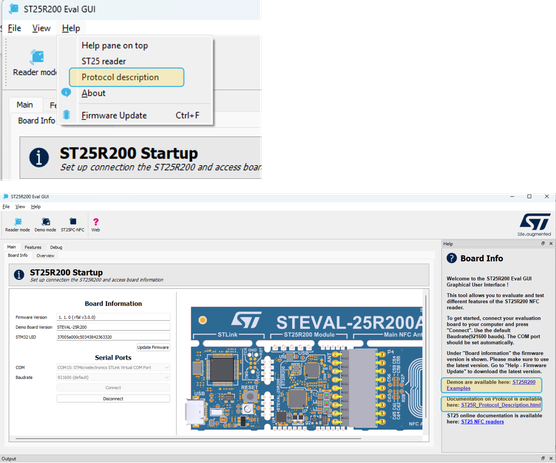

Grégoire Poulain
Hi MelioNB,
After installing the EVAL GUI you can navigate to the example folder and also browse the Protocol description between the PC and the board. See below:
Using the APIs provided one can issue individual commands/frames at will.
In your case, for ISO15693 / NFC-V a plethora of commands can be performed, eg:
rfalISO15693TransceiveAnticollisionFrame
rfalISO15693TransceiveEOFAnticollision
rfalNfcvPollerInitialize

Grégoire Poulain
Hi MelioNB,
