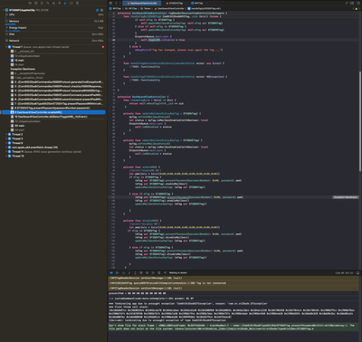

I am trying to enable the Mailbox functionality on ST25DV64KC-DISCO board.
I am using the NFCTap project,
And inside it added my own storyboard and a View controller.
This view controller first detects a tag at launch in view didload,
then it fetches the mailbox status,
and lastly it tries to enable mailbox with presentpassword api on which it crashes.
I have also attached a screen cast.
Please let me know if anyone faced a similar issue and can advice a solution.

Hello aly,
Error message in your debug console is quite explicit: you 're not connected with the tag, and you try to send a command. So, you get an exception.
So :
- Verify why you re connected with tag (do you stop nfc session ? Distance from tag & reader too far ? ....)
- Catch your exeption by using the example provided in source code of NFC tap with the "SwitfTryCatch" class.
Hope it helps.
