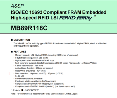

If using the Read Multiple Blocks Unlimited proprietary command to read for example 6 blocks:
| 7 bytes transmission | 1.92ms |
| t1 | 0.320ms |
| 51 bytes reception | 15.7ms |
| t2 to next command | 0.309ms |
Total duration is 18.6ms to read 6 blocks of 8 bytes, so about 37,2 ms for 96 bytes
I would personally use this Read Multiple Blocks Unlimited proprietary command and read 4 or 6 blocks per requests.
| t1 | 0.320ms |

"The tag on the customer site may not support Fast Read, so I still have to use Read Multiple Blocks command": please note that Read Multiple Blocks is an optional command from ISO15693 point of view so if your customer uses another tag, it may not support the Read Multiple Blocks command. It may also support another block size (e.g. 4 instead of 8 on MB89R118C) and may support a different maximum number of blocks for the Read Multiple Blocks command (when supported).

"regarding the read multiple blocks unlimited proprietary command you mentioned, I didn't find this command in the demo" The read multiple blocks unlimited command is a proprietary command of the MB89R118C device. The demo provides the support of
Thus, the support of read multiple blocks unlimited command is not provided but one can easily add the support of this command.
