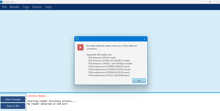

Hello, I am trying to get the ST25PC app to connect to a FEIG-CPR30-LCN9620 which I believe should be supported; however I not able to get the correct drivers to do so(Which I believe is the problem); I downloaded the most recent drivers from Feig website and tried some alternative drivers I also tried on the most recent ST25PC download as well as an ALPHA version that supports CPR30+, I was able to get a FEIG MR102 connected to the ST25PC, This if for a project using the SDK which also works with the MR102 however has problems connecting to the CPR30, I on the most current Windows 11 update.

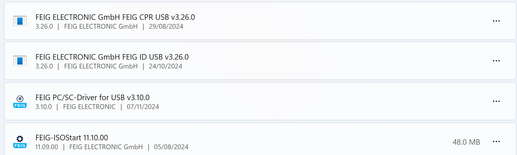

Hello, thanks for the response the problem has been fixed by installing the cpr feig driver on a different pc and then transferring it across as it seems like the feig drivers do not uninstall properly and the FEIG CPR USB Driver, not PC/SC USB Driver for CPR readers (incl. FEIG CPR USB Driver) for Windows.

I also use the USB driver version 3.26 like you showed, but on Windows 10. According to the description on the FEIG Electronic website, it should also run on Windows 11.
As a sanity check, please ensure that no other instance of the ST25PC-NFC software is open and that only the CPR30 reader is connected to your machine.
From your screenshot, you are right in assuming that the CPR30 is not recognized by your Windows machine. What happens when you try to run the ISOStart software from FEIG Electronic (v11.11 as shown)?
