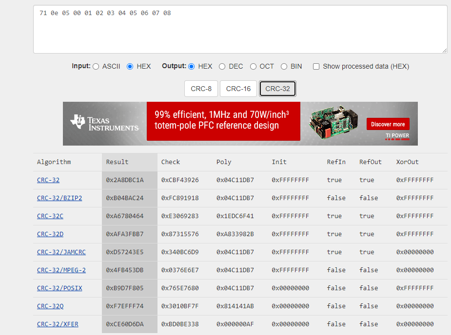

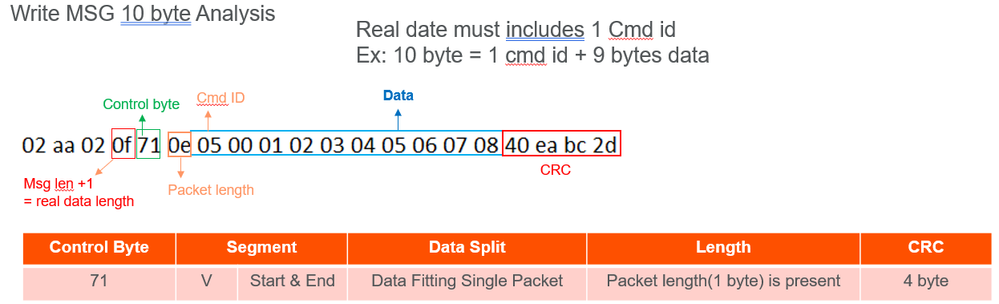

I used NFC Tap App to transmit data(use FTM write message cmd), transmit 10 byte
As my analysis below the last 4 byte should be the CRC(4 byte),I think it's use CRC32 method, but I can't calculate the result as same as the App
Results by using on-line CRC calculator
Could you please verify this for me? thank you very much!

2022-09-12 2:14 AM
Hello Jerry,
I think you are mixing the Write message command (ISO15693 frame) with something else.
The Write Msg command format is:
02 aa 02 | 0f | 05 00 01 02 03 04 05 06 07 08
cmd code | msg len | data
Control Byte and Packet length and CRC32 you are inserting in the middle of the Write Msg command do not belong to this command.
Best regards.

2022-10-02 7:26 PM
Hi, Sorry for lately respond because I just ignore the CRC and proceed to develop my application.
The protocol I described is "FTM protocol" which you can refer to below url:
And I just wanna find which CRC32 method was adapted in ST FTM protocol
Thank you!
