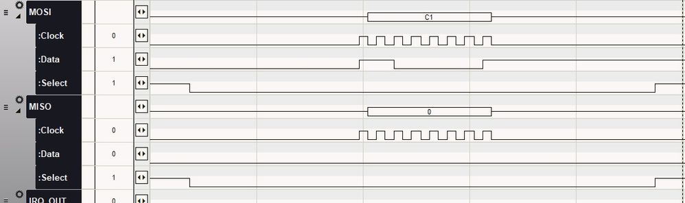

Regarding your initial question, the direct commands values in table 13 of the ST25R3916 datasheet include the heading 11b. This simplifies the reading of logic analyzer traces as we have the direct value of the byte being sent.
For example, here is the sending of Set default (C1h) command on SPI

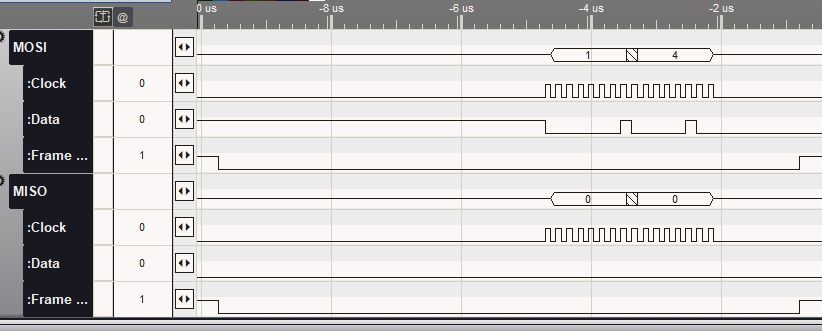

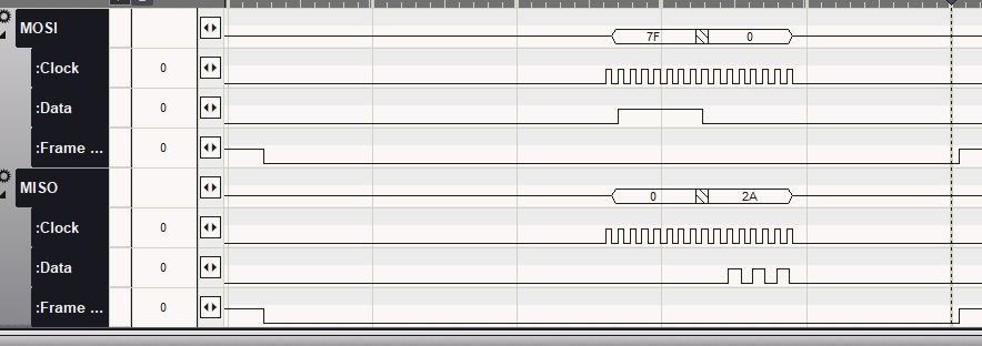

Hi Antoine,
here is an example of reading the IC identity register (3Fh):
here is an example of writing IO configuration register 2 (01b):
