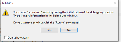

2024-10-16 12:42 AM
Thank you for directing me to the section. I tried but now the code does not run properly with these settings. I get a pop up indicating there is a warning in flash loader and map file generates so many veneer sections (I have no clue about these). Below is the debug log for the same.

Wed Oct 16, 2024 13:05:39: There were 1 error and 1 warning during the initialization of the
debugging session.

When I try to download the image using these settings, I get the below error and the debug log contains similar to the log I posted in above.
After that When I proceed further, I get another pop with below message
and then if I clock on yes, the control stops at main. Now if I go for debug further, the control does not come to the "scheduler_function2" at all. It stops in "scheduler_function1" itself.
