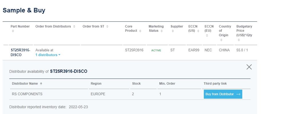

I tride to buy ST25R3916Disco, but there was no distributor that had it in stock.
Is there any other way I can evaluate the read performance of the ST25R3918?

2022-06-07 12:51 AM
you will find distributors on https://www.st.com/en/evaluation-tools/st25r3916-disco.html#sample-buy:
Rgds
BT
2022-06-09 12:25 AM
Hi Brian,
Thanks for your reply.
I checked RS COMPONENTS site on the all country in EUROPE , but all say "we can't find results" or
"Permanently discontinued"
Can I use "X-NUCLEO-NFC06A1" for the same purpose as �?ST25R3916Disco�??

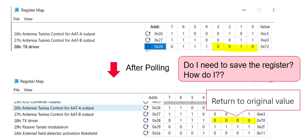

I tried to change TX driver register to 2.
I set d‗res in register 28h as follows, but after running Polling, it reverts to the initial state.
Do I need to save the register values I changed? How do I save it?
2022-06-29 12:21 AM
Hi Hiromi,
the register map is more of a visualization and playground for the registers. Configuration is done by means of the analog config also available as a tab in the GUI. Also the DPO will be playing a role here. Looking at especially d_res I see the following (potentially competing) mechanisms:
So for playing with d_res I recommend to go to DPO tab and to disable it, and then on Analog Config tab set the value inside the CHIP_INIT mode and "Write to board".
Please be aware that in standalone/on-board GUI mode I assume it will switch back to DPO enabled and your settings likely are not used any longer. So better to evaluate based on PC GUI. If needed you could in a second step recompile the firmware with disabled DPO and change d_res default.
BR, Ulysses
2022-06-29 5:57 PM
Hi Ulysses,
Thank you for your answer!
The problem has been solved!!!
Sincerely thank!
