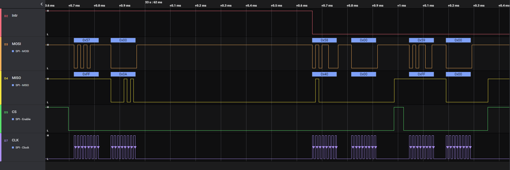

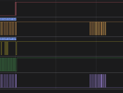

2023-07-05 1:33 AM - edited 2023-07-05 1:35 AM
Attached ErrorCapture.hex (Real extension ErrorCapture.sal) Capture made using https://www.saleae.com/downloads/
https://drive.google.com/file/d/1HP3trKfch0tgLm-TP4rdvEN691bfpKf_/view?usp=sharing
Error happens before 50 ms gap
2023-07-05 2:20 AM
two issues seen here:
Which code base was the basis for this Rust driver? Must be quite old as the single interrupt reading is not recommended for quite some years (even before ams->ST transfer).
Best Regards, Ulysses
2023-07-05 3:43 AM
Ohh never noticed that CS behavior. That explains a lot :) Will investigate and post an update of what happened here.
I thought reading multiple registers in one attempt is just optimization and reading multiple times would be fine. What kind of problems it can cause?
I used
https://github.com/nrfconnect/sdk-nrf/tree/f18f6929e239f01125d349dc8543c940b45b2001/lib/st25r3911b https://github.com/stm32duino/ST25R3911B
2023-07-05 4:24 AM
both codes on github are using read multiple for interrupt status. If I recall correctly when using single reads it can happen that interrupts are lost (cleared without being present on MISO).
