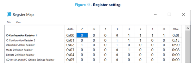

I am afraid that I am doing something wrong in the other registers. When re-flashing the chip I started fresh with the configuration suggested in the AN5592 for the differential antenna as shown in the image:
It does not add up to me, however, that by changing the parameters you suggested in the previous response, from the Spectrum Analyzer, I see no significant difference. Do you have any suggestions on what to do?
If, by any chance, I am doing something extremely ***, I attach here the register's content of the chip to complete the description of the problem.

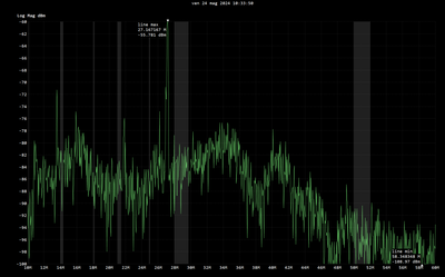

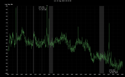

I acquired some pictures of the Spectrum Analyzer so that you are able to see what's going on. I also saved the registers' content while coupling between tag and reader was happening so there should be no unexpected values in the registers.
Just to give you a bit of context, I am using a passive NFC tag with a ISO/IEC 14443-3 Type A based interface.
This is what I can see from the Spectrum Analyzer when 0x2A = 0xC0 , 0x27 = 0x7F (scenario1):
While this is what I saw on the Spectrum Analyzer when 0x2A = 0x00 , 0x27 = 0x00 (scenario 2)

2024-05-24 4:37 AM
Hello Luigi,
I don't know why your 2nd harmonic (27.12MHz) is so high.
You can see a nice reduction on 13.56MHz from -61dBm to -71dBm.
How do you connect the SA to the PCB? If you are probing at the RFO directly, it is quite clear to me. The chip is outputting a rectangular signal, which is converted by the EMC filter into a sinus.

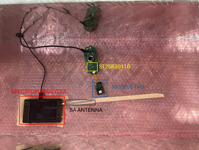

- I am measuring the spectrum using a SA as in the setup shown in the attached image:
The setup is installed inside a metal box.

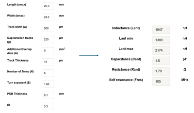

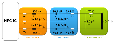

Assuming that we are using an antenna (for the NFC) that has this characteristics:

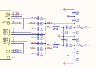

Using then a tool for the antenna matching I found out that the suggested matching circuit is this:
Which is not that different (at least for the EMC filter) with respect to the one used on the custom PCB I am referring to, which is the following:
So, assuming that the coupling circuit is well designed (I hope that makes sense to you as well), my final guess to try to solve the problem involves AM modulation.
In both scenario1 and scenario2 files that I attached to my previous message, I saw that the contents of register 0x09 has bit 5 set to zero. This implies OOK modulation which in the case of an ISO/IEC 14443-3 Type A tag is not working properly.
I was wondering, the Analog preset command, from the information obtained from the configuration register (0x03) should automatically set the correct modulation type for the specific tag but this does not happen. Assuming this is the problem (I'm not sure because I don't know for sure how the chip behaves and whether it changes the settings and then resets them with each coupling cycle), could you help me understand this properly?
Also, if you find any obvious issue with the HW matching circuit please let me know because it seems fine to me and I don't want to go in the wrong direction keeping you busy with my questions.

2024-05-27 2:11 AM
Hello Luigi,
Getting one step back, I try to summarize:
Initially you wanted to reduce the output power of the ST25R3911B.
Measuring the field strength with a SA you have seen that the higher harmonics are quite high.
The explanation for this is, that NFC is based on magnetic coupling. Two loop antennas (some people are quite strict and claim that this are coils and no antennas) are communicating via magnetic coupling. The SA uses a normal E-Field antenna, which is most probably "only" sensing the electric near field of the PCB.
In other words, I have doubt that this setup is appropriate to evaluate the magnetic field strength of NFC systems. I would recommend to measure the field strength according to ISO10373-6 chapter 5.3 or 7.1.1.
Do you have any issues regarding the 2nd harmonic - 27.12MHz and any emission test / emission standard?
Please let me know, if this helps you.
