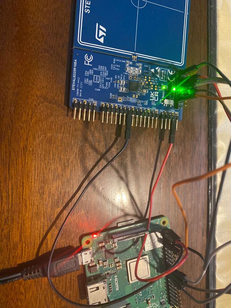

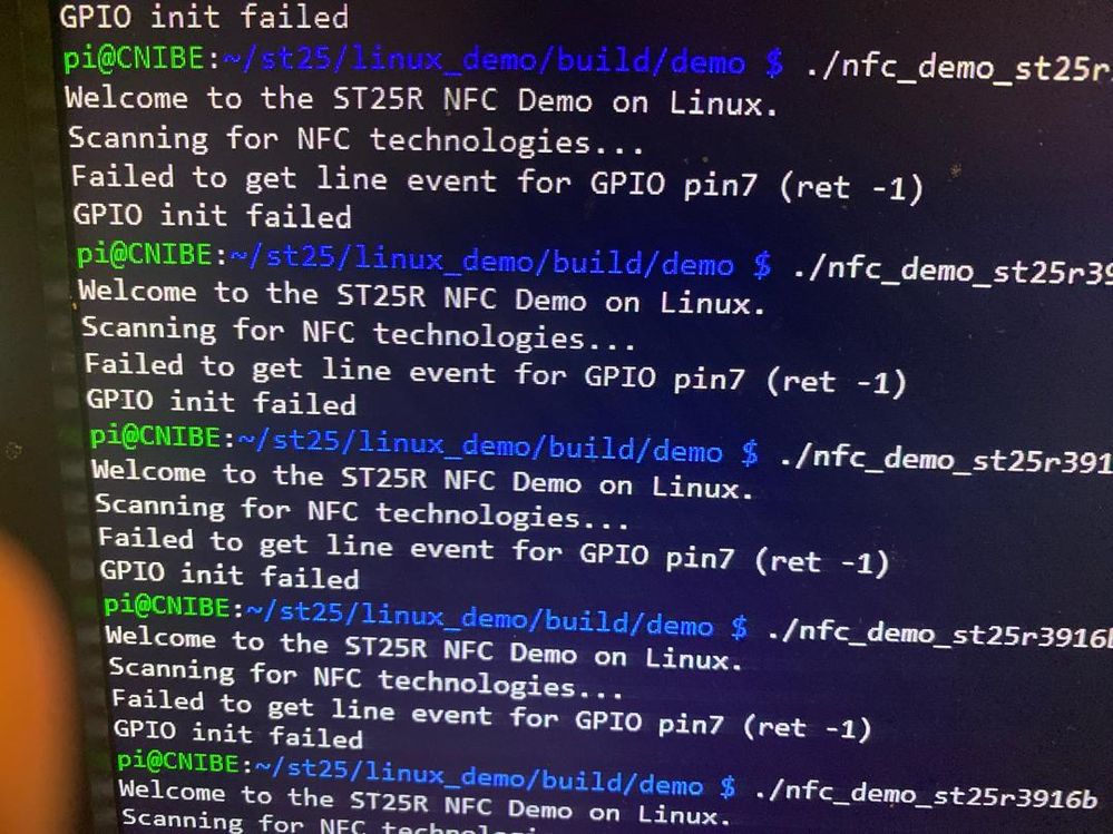

I connected a Raspberry Pi 3 to the ST25R3911B-DISCO and used the Linux driver suggested by ST.
However, I haven't been able to successfully detect the IRQ despite following the setup.
Any suggestions on troubleshooting this issue?

I have already seen that. It happened with newer Linux kernel and SPI driver that controls by default GPIO8 for SPI0 CS0 and GPIO7 for SPI0 CS1 (e.g modinfo spidev: v5.5.61).
There is a conflict with the ST25R NFC demo that uses ST25R_INT_PIN on GPIO7 as interrupt line between the reader and the microcontroller.
To overcome this, configure the SPI driver to control a different GPIO than GPIO7 for the Chip Select signal.
This can be done with the dtoverlay command.

Edit the boot configuration to use this overlay, add the following line:
$ sudo /boot/config.txt
dtoverlay=spi0-1cs
$ reboot
The parameter cs0_pin may be needed in case the driver assigns CE0 to another pin.
e.g. dtoverlay spi0-1cs,cs0_pin=6

well, you are not showing a ST25R3911B-DISCO but a STEVAL-2543916B board.
The error message you are getting indicates that in your system somebody else uses the GPIO7. This should also happen without the 3916B board connected. I think you need to look on your Linux to see the usage of the different GPIOs.

2024-10-09 1:55 AM
i have install new image in my rasp without any other program
