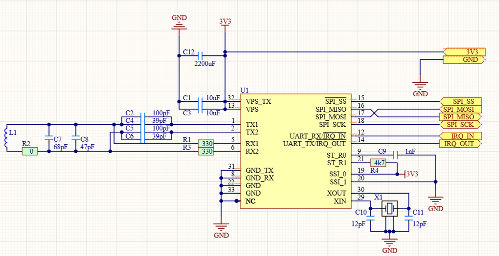

To test the behavior, I decided to reproduce his on STM32F401 Nucleo-64 connected to CR95HF by wires on my board similar to connection X-NUCLEO-NFC03A1 expansion board.
But the choice of the communication SPI interface is not carried out by F401 side. SSI_0 have direct connection to VCC.
C12 added to observe the slow discharge on oscilloscope. When the discharge reaches 220 mV, I connect Nucleo board to USB.
See attached schematics connection.

in the "INIT_ERR_24 MHz, 240 M Samples [13]" trace, I see no life on the SPI MISO. This is due to internal logic being not properly reset as the VPS has not been set to 0 but to a non-zero transient value. If there is a general power off, one must make sure that VPS returns to 0V before next startup (as written in the datasheet in §3.2).
Maybe the value of C1 and C3 is too big and prevents the VPS from returning properly to 0. I would suggest to have a look on the power supply schematics of the X-NUCLEO-NFC03A1 (see UM2479
Getting started with X-NUCLEO-NFC03A1 NFC card reader board based on ST25R95 for STM32 Nucleo)
